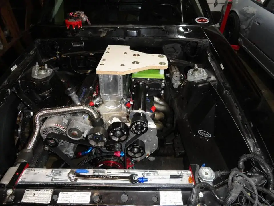

This picture is dated but gives you an idea. The alternator now sports a 4" dia pulley and the supercharger has been moved up 1.5" and forward 3.4". Plus the support plate for the supercharger and idler pulley has been refined, but that does not change the basic layout of the drive belt. The whole point of wanting a HD tensioner is that if it fits in the stock location, then I don't have to monkey around with fabricating something else up to accommodate it. Lord knows I have customized so much as it is, that I would like to take the easy way out on this if possible.

How high does that thing sit?
It sits to high for a stock hood for sure. I am still in the finalizing stages of the build. One thing leads to another and the next thing you know you are re-engineering everything to take advantage of a change that was made, that at the time seemed to be insignificant.
I do not know yet. But if one were to not raise the supercharger 1.5" like I did, then lowered the k-member in the car a bit, which you would offset this increase in ride height with coil-over struts, then maybe not much of a cowl at all. My finished inlet would have to be revised to place the throttle body lower, but it is all do-able. I will certainly take some pic's and measurements when it is all said and done. Right now I have a Harwood 6" Carbon fiber cowl hood that goes to the windshield, and some base measurements show that it is much bigger than I really need. But hey, it looks Kool.
