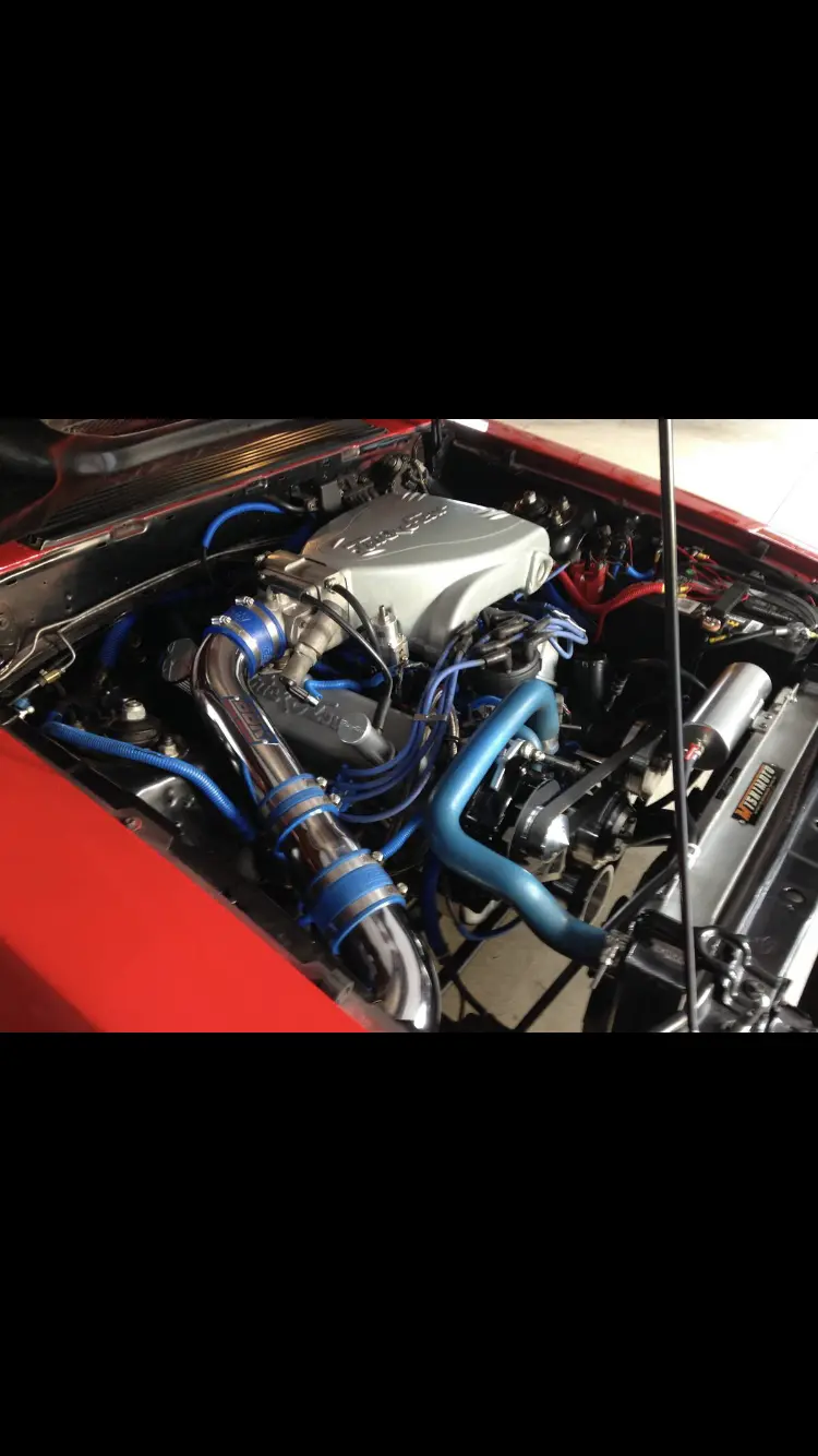

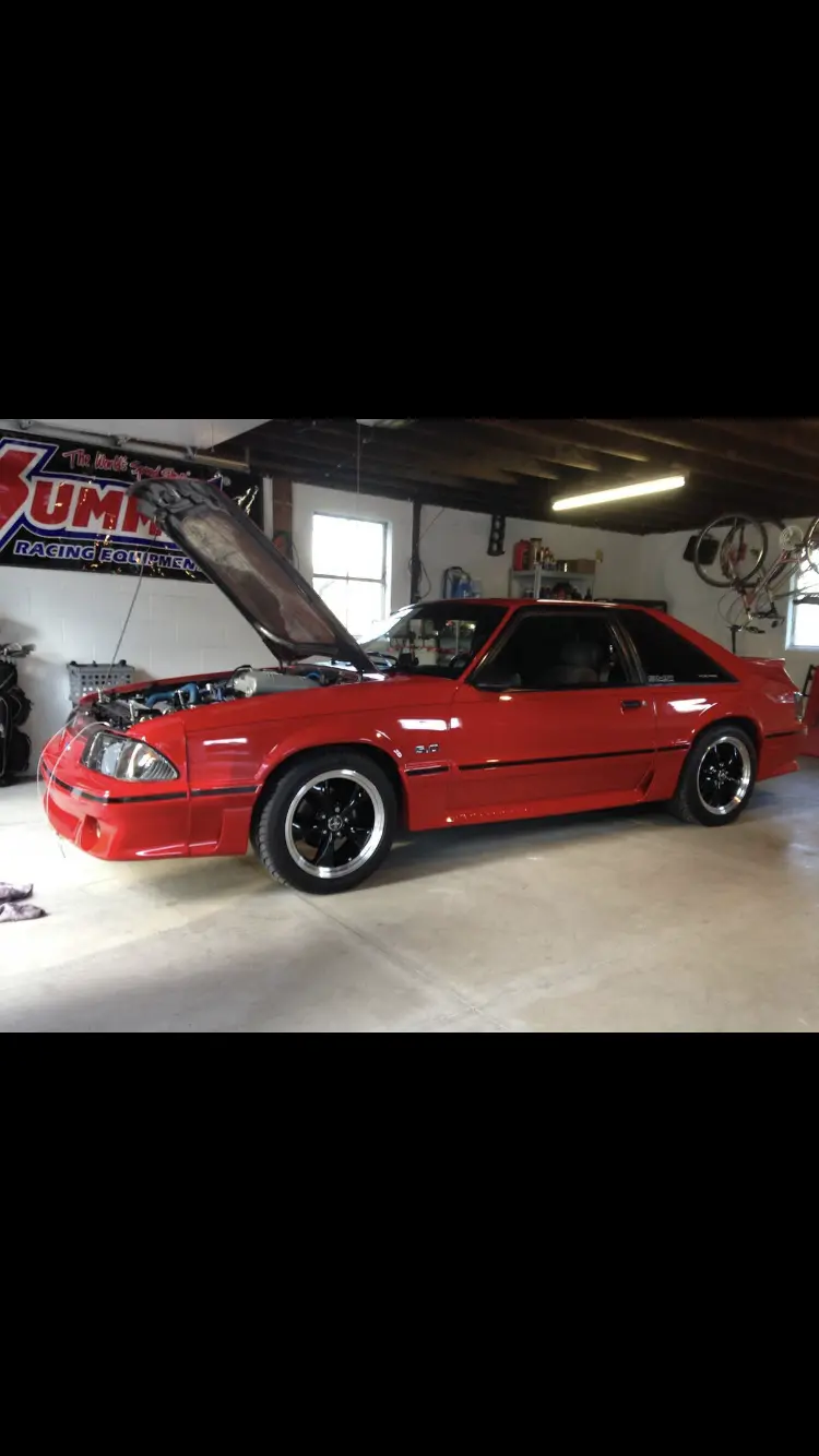

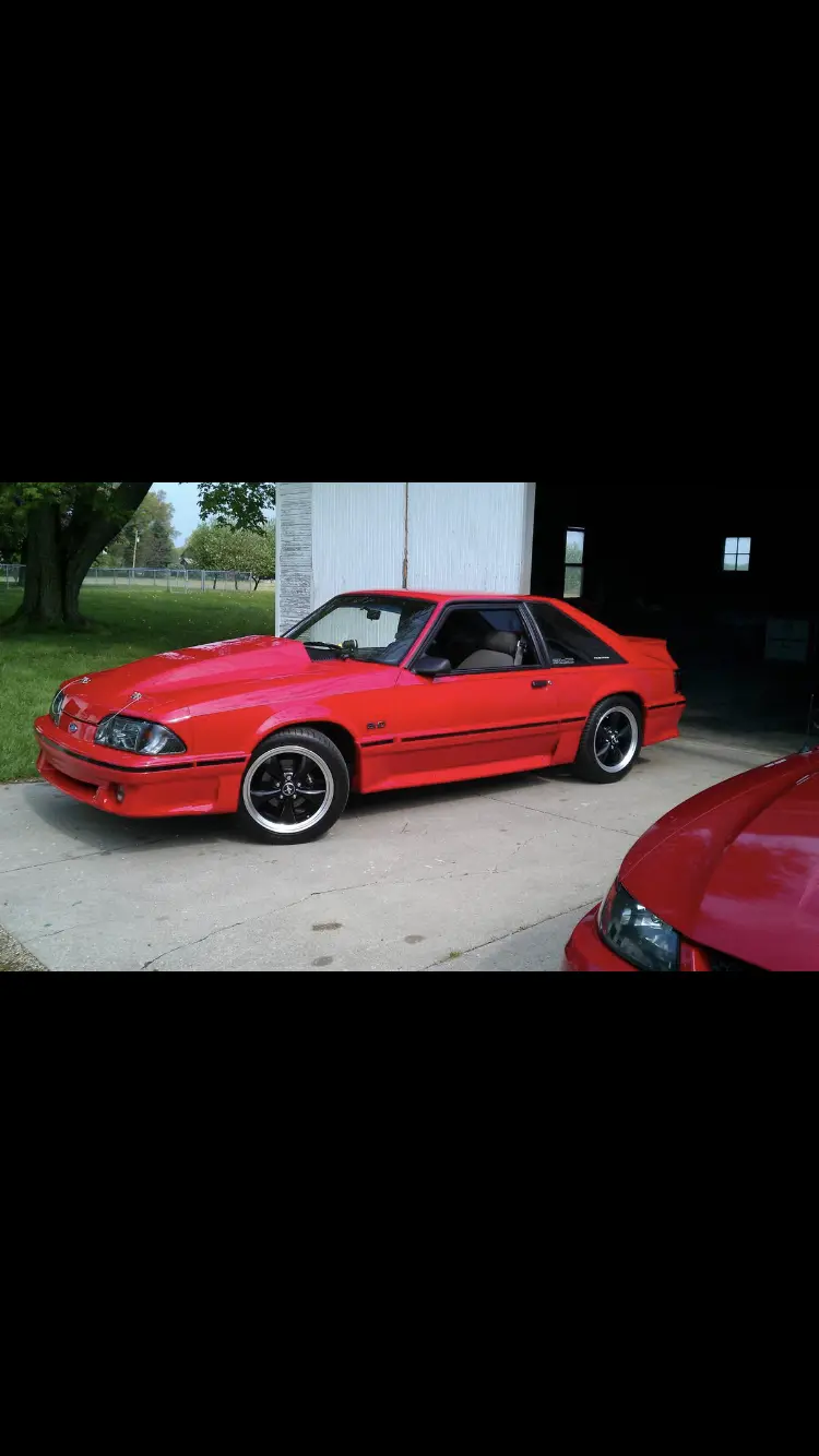

Thanks guys. Here are some other pics for reference

Man.... $6500 I’d jump on it. I’m probably into mine more than that, and it’s basically stock still.
That’s a sharp looking, clean car (from the pics). Obviously a real good visual of the usual suspect spots would be needed before I handed over the cash.

Looks like a pretty nice car.
Some things to note, the headlights and tail lights are crap, you will want to replace them with factory versions if you drive at night. (which are not going to come cheap)
Hard to tell, but looks like a bullet mass air meter may be in there clocked so we can't see the sensor.
That car should NOT have needed tuning to make it idle, so something is wrong. Whether the chip fixed it or not, it's masking a real issue (which is probably something simple).
No AC, i'd wack someone for at least $1000 off for having no AC. Even if you don't need AC, it severely hurts the value of the car, it's a stupid modification that nobody should do.
Make sure the brakes feel right, it's weird upgrading the fronts but not going to discs in the back and i don't see an adjustable valve on the firewall.
You may want to replace the intrax springs.
Hope you are tall, that hood is massive.
If you buy it, make sure that intake takes a 75mm tb. I'm not sure on the trick flow, but most only take up to a 70mm, so that could leave a 5mm lip.
Probably recoup some money by selling off the unecessary massive Tach in the drivers compartment (which i hope is not screwed to the dash).
Overall, i like the car and there is a some room to make some minor changes to make it yours and i think the $6500 asking price at a glance is pretty fair. With that said, i still think you are going to put some money into it.
