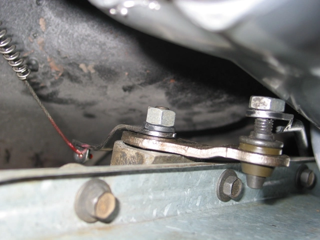

Here's a pic of my AOD shifter and TV connections (I know the bolt is not tight, it was a test fit):
I had to change my throttle linkage, but NOT because of the AOD. It did not work with the Holley.
The stock C6 shifter should work fine if you can fabricate (or buy) the correct rod to connect it. Since you have an aftermarket shifter I'd suggest you contact the manufacturer. I'm pretty sure it will work if you can get the correct part from Hurst though.
I reused all the old parts from my 68 on my AOD. I am still using the stock shifter, but with a longer shift rod. I am not using a TV cable because the original kick down cable works the same way in that it is a 1:1 motion. This set up has worked good for the last three years with no issues.
