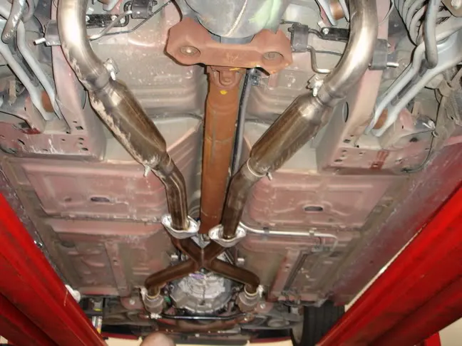

jk, yeah man, its an SLP X. now Ive got O/R pipes on it. this seems like an appropriate time to whore out the underside of my car.
