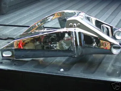

92notchback347 , ALMOST STOCK knows a thing or two about polishing, but maybe my sunglasses are too dark:
Those are done by him, don't worry. He's done parts for me that I couldn't do well enough and I will vouch.

Finished aluminum should look like chrome, just like AMOST STOCK's engine does. I finally found a use for this sign...
