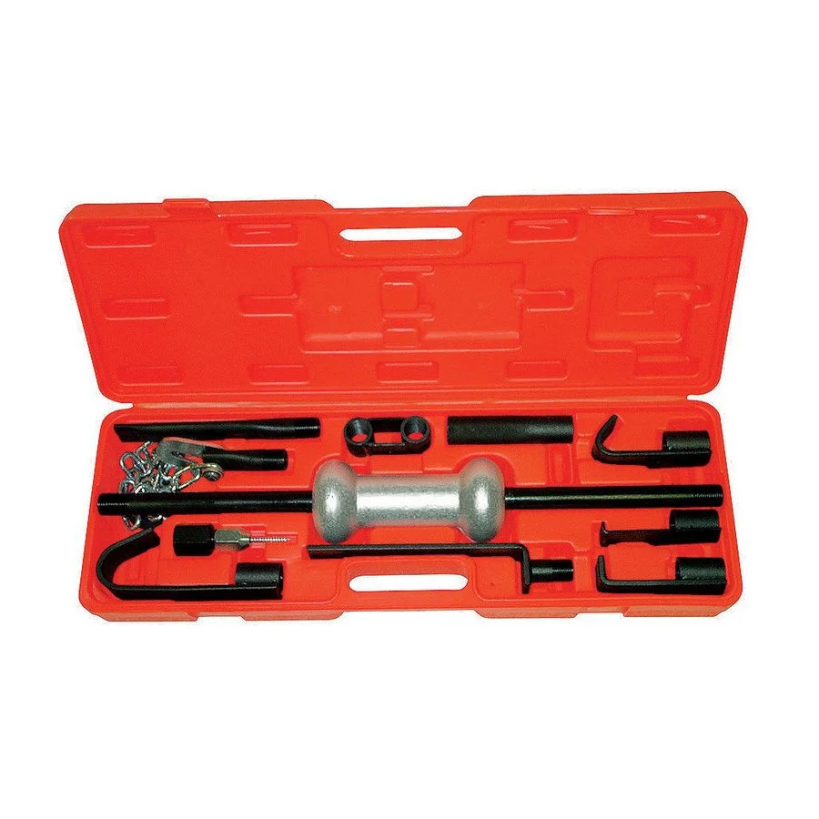

The 'best' way to get them out with with a slide hammer and hook. It doesn't take much if you work your way around as you slide it out.
It really only requires being "tapped" out with this tool although I have seen folks use it to make a mess.
