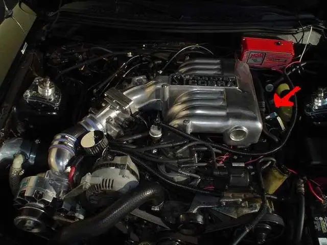

I cant quite remember what happened next, but it somehow leaked out again, and I filled it again...... Only to find out that the valve pictured below, leaked after hooking up the fill majigger to it. I put the cap on real quick and tight, and believe it or not it held pretty well. Now, if I take the valve cap off, it starts to leak. My a/c now blows cold only when its semi-cool out and if im moving. If the car is hot or im stuck in traffic, it does not.
Im tired of dumping money into this stupid a/c problem, but before I replace everything, I was wondering what you guys think of this. I was gonna replace the valve pictured, getting one of those cheap a/c refill kits from auto zone and seeing what happens. As far as I can remember, I fixed all the leaks and since it does blow cold sometimes im thinking its just low on refrigerant. What do you guys think I should do? The valve is like $10, and a refill kit is like what....$50? Should I spend $60 now and see if it works, or should I go ahead and spend $500 replacing everything again.
Another question, does that valve just unscrew and then I put the new one on?
Sounds like the valve seal is bad. I'd replace it with a Ford one only. Don't use the local part store ones they don't fit. Then you need to evacuate the system to see if it holds pressure. Then recharge it. You can purchase the hoses from the local part store for cheap. You can get a Vac cheap but you need an air compressor. Search under Methodical and you will find one of my post about doing the recharge. I will chime in again just at work now and can't remember everything. But search under my name.

If your compressor is cycling on and off, you most likely have a low charge. It's possible that there could be some sort of obstruction (possible blocked orifice tube) in the system that's causing the pressure to build on the high side and cut the compressor off until it equalizes, but I'd put money on it being a low condition because of the previous leak. I believe you can just replace the valve without having to replace the whole line, but I'd have to go take a peek at mine. I'm almost positive it will unscrew from the line. I need to do this myself, too. I left my hose from my manifold set attached because it leaks so bad, I'd lose my entire charge in a matter of a minute or so. Just kept it hooked up with the valve closed.
