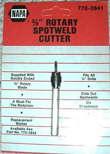

This worked nicely for the cowel spot wells:
You drill a small pilot hole through the center of each weld first (to accept the spring loaded pin of the spot weld cutter.)
