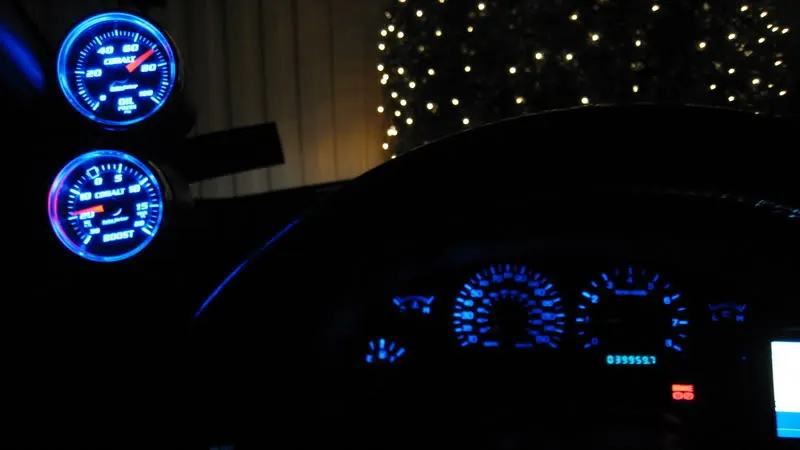

Saleen4971 said:
boost/vac and fuel pressure are the best to have with FI
I disagree, but to each their own. I think Boost/Vac and Oil are musts. Yea, Fuel is great, but if you have no fuel, the car won't run. Simple. However, if you're leaking oil, you can watch your oil guage slowly drop in psi and shut her down before. Fuel though, if nothing is there, pop! done.
As for the cobalt guages, great choice!
