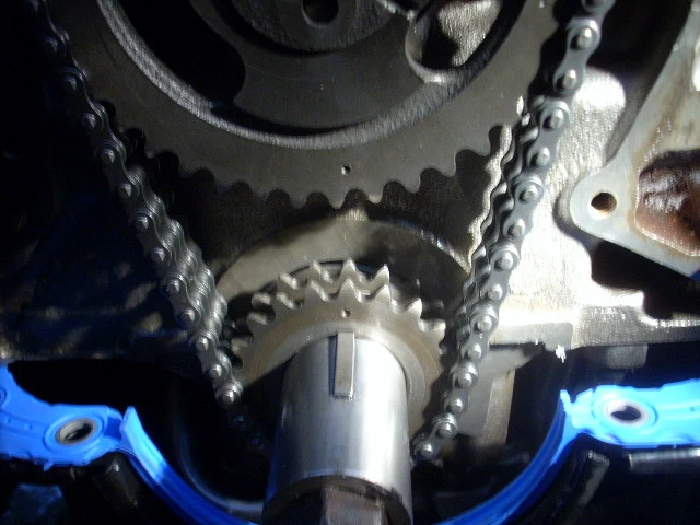

I have a crane cam and I need to know which timing chain is the correct one? I bought the Cloyes 9145 and that did not fit, the teeth pitch is 1/4 and not 3/8. So I bought the Cloyes C163 and the chain fits the sprockets. I tried installing the chain together with the cam and crank sprocket and cam pin is in the hole of the sprocket and I can't get the cam gear to fit flush so I can put the bolt in. I don't know why it won't fit? I don't want to force it on and should it fit like a glove? I compared the chain to one that came off the car and it looks the same. Why won't this timing chain fit? Do I have the correct timing chain? On Rock Auto here are all the chains that are available and there is also a Cloyes C370 chain but I don't know the difference between the other ones. Which chain will fit?

Can you take a picture of the gear not sitting flush. If I remember correctly, I don't believe the cam snout comes out even with the sprocket. I may be wrong about this, I haven't done a cam install in about a year.

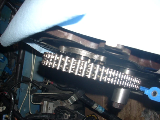

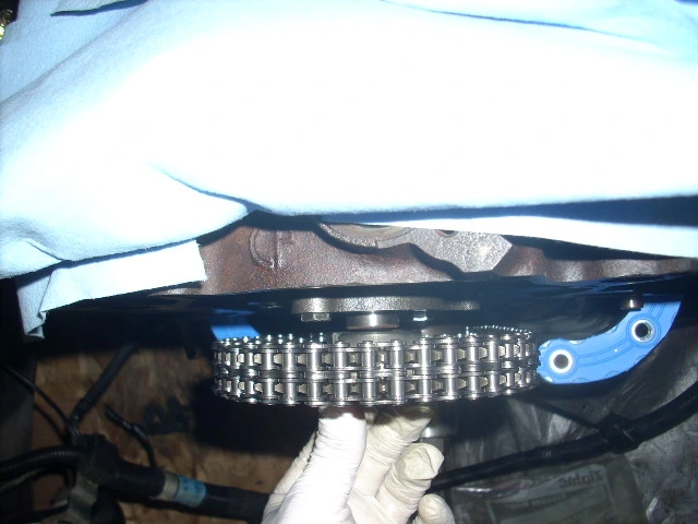

Here are some pics. As you can see in the pic, the cam sprocket won't go in any further. The cam pin is lined up properly and I put some light force on it and it won't in any further. The old chain goes in nice and easy, but of coarse it is a little stretched out. If I remove the crank gear, the cam gear sprocket lines up nice and flush, but if I put both cam and crank gear on the same time, the cam sprocket won't line up. Do you think I have the correct timing chain? Since the timing chain is new, does it need to be lightly tapped with a soft hammer? Any ideas?

So, it appears as if the chain is not long enough to allow the sprocket to slide onto the cam? Or is it that the sprocket will just not slide all the way back? I assume you have applied oil or assembly lube to the crank and cam to assist in sliding them on? Again, if I remember correctly, there isn't a lot of extra slack. If both sprockets are not just so, they won't slide on. I agree with you, if they don't pop on with a slight tap of a rubber mallet, don't force it.

Yes, it seems like the chain is not long enough, if it had a few more links on it it would fit nice. And yes also the cam sprocket won't slide all the way back and I did put some light oil on it. This C163 chain is the for the 5.0 Mustang but I don't understand why it does not fit? Guess, I will have to buy another timing chain and see if it will fit. Maybe the 9130 will fit?

Today, I tried wiggling the crank gear back and forth while pushing on the cam gear and still does not go through. Then I put the crank gear on first then the chain along with the cam gear and still it won't go in. I'm pushing and wiggling and nothing. I'm going to buy a few other timing chains and see if they will fit..

I also compared the old chain to the c163 chain and both are the same size. I'm thinking since the chain is new and tight that maybe it needs to be tapped with a soft hammer? What do you guys think of that?

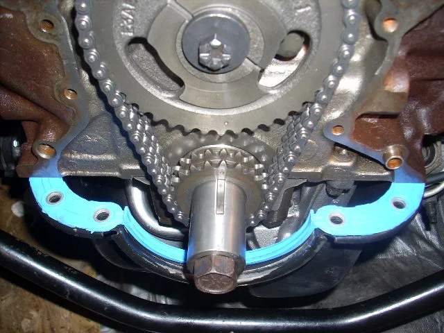

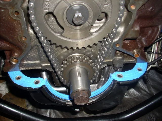

I finally got it in! I lined it up as seen in my first pic and lightly tapped it with a soft hammer a few times and it went in. Before I tighten the bolt...How do the timing marks look? Am I off a tooth?

Man, glad you got it worked out! Its not perfectly dot to dot(just based on looks of it) but i bet thats a close as it will get. Glad you got it worked out.

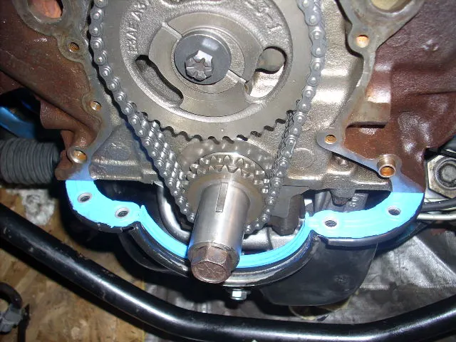

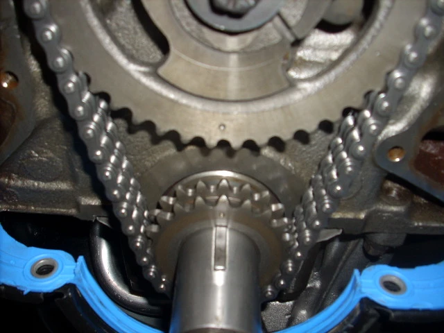

How about now? I moved it a tooth over.

I'd say that looks pretty dang good!
