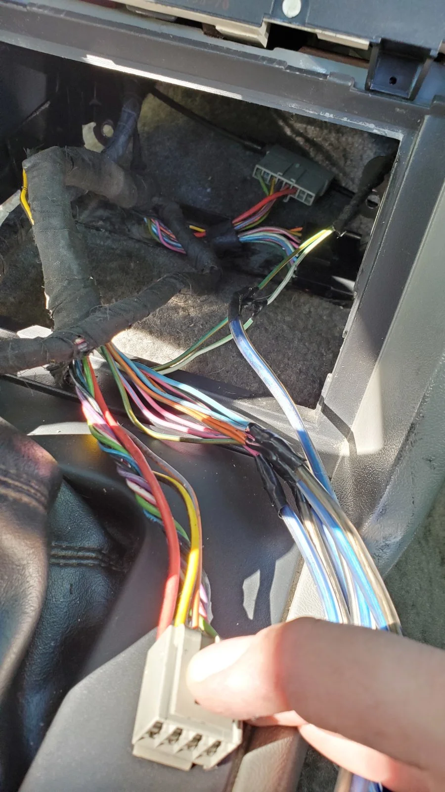

Hate to piggy back on someone else's thread but I am having a similar issue. Only I'm trying to re install the factory stereo. I believe I need to track down an amp side connector and amp to be able to piece mine back together. Does anyone know of where I might be able to get another amp connector or harness besides a junk yard?

I do need to amp as well which is why I'm especially interested. Sounds like it's definitely worth the gamble then. If I am able to score this then I just need to figure out where to reconnect the door speakers as they are currently spliced into the current amp harness that was hacked up.

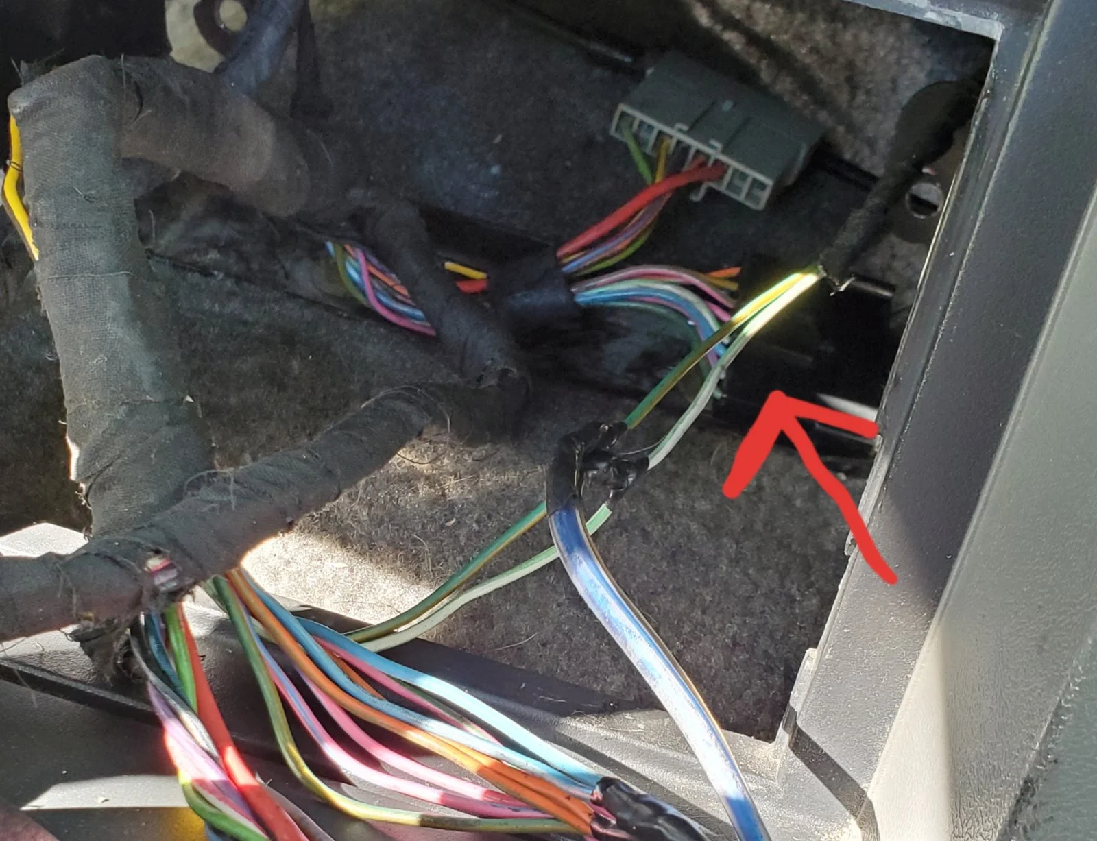

Is any of the factory wiring for the doors being used? That wiring splices into the body harness after the amp harness. The factory wiring has a few plugs just inside the doors under the dash, and taped up on the doors if not being used.
A factory premium sound car has the amp and 6-speakers. The standard stereo is 4-speaker and lacks the doors. Often people add the door speakers in and run the wires. They don't have the amp and amp harness though.
I'm not sure about the factory wiring for the doors, I would need to take things apart further to chase the wires. The car was originally a premium sound car. It appears when the previous owner had the new head unit installed they also installed new door speakers. In the picture I posted, the two wires pointed out by red arrow are what I believe are running to the door speakers. But they are tied into the amp harness, which if I'm not mistaken should be able to be unplugged and removed. So that's why I'm confused as to where, from the factory, the door speakers are wired in.
