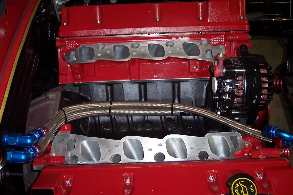

I intend to build adapter plates to allow me the option to use a 302 carbureted intake manifold on my 4.6. The ports are so far apart a 302 intake will sit in between w/ probably 2-3" on each side. Right now, I plan to use 3/8" steel plate on the head and intake mating surfaces, and probably 2.25 round header tubing for the transitions. I'll have to do something about the alternator, maybe get a smaller one and put it on the rear end, or turn this one around and drive it off the existing belt.

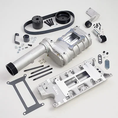

That was the reason for the E85 thread, to determine what people thought of it if I choose the last option and put the huffer on it. either way, I'm keeping it old school carb'd, just maybe add 2 or 4 more barrels, or some boost to the mix.

I cannot make a sheet metal intake that will allow me to run 3 2's, 2 4's or that blower as easy as making the adapters. And once those adapters are made, I have the flexibility of running whatever I choose. I remember some company made those adapters to allow those intakes to fit a 4v, but not a 2v. I think Kar Kraft made them. ( the same guys that brought us the Boss 429 conversion) Unfortunately KK is gone.

I'm just saying that the expense and time I'll have in the adapters will only be "cushioned" by the fact that adapters can be made out of steel that I can weld. The fact that they are relatively small as compared to an entire manifold means that they wont be too heavy, the ease of changing out the center after that is what,......12 bolts?
