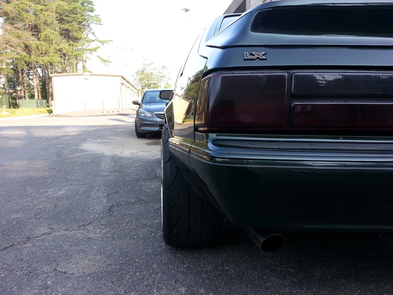

I just eyed my the best I could from factory pics. Everyone told me to leave it off but its not every ones car..... pic for reference.

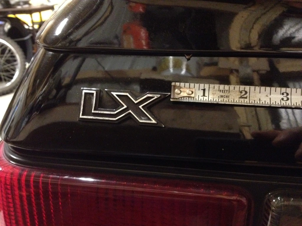

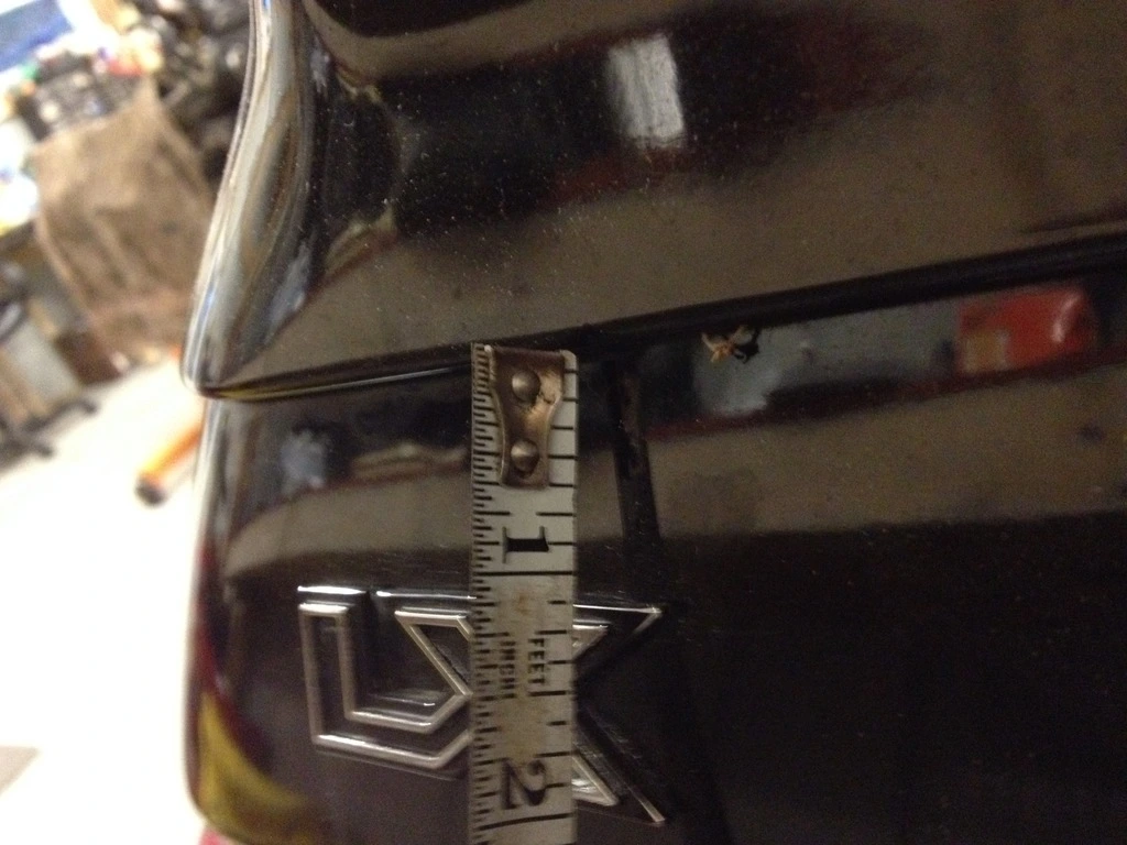

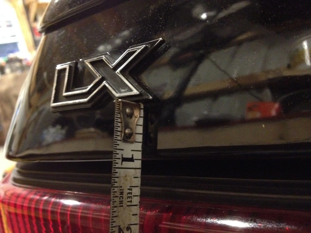

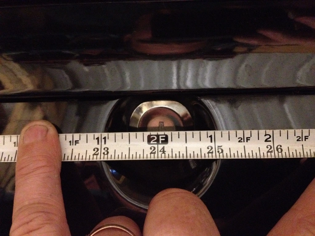

These are measurements from my 92
From the upper right corner of the X to the center of the lock cylinder > 24 1/8" (first two pics)
From the bottom of the X to the bottom lip of the gate > 7/8"
From the top of the X to the bottom edge of the spoiler > 1 1/8"
