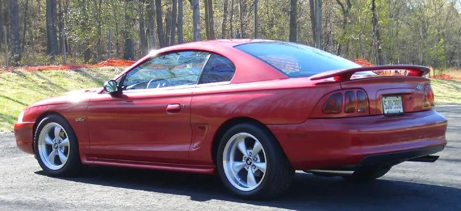

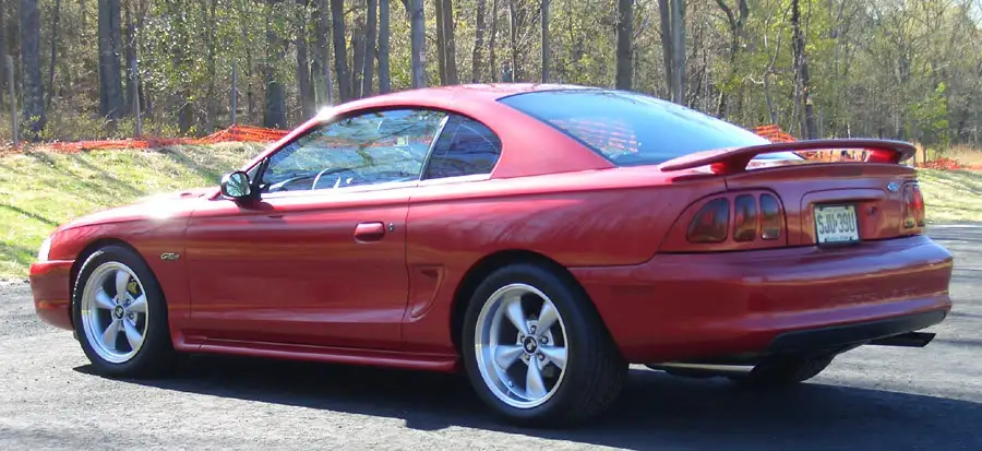

I recently took my eibach prokit out of my car and removed all the isolators. It dropped the front about 3/4" and the rear about 1/2". I don't have any noises that I didn't previously have. I just wrapped the bottom two coils on both ends off all the springs with 2 layers of duct tape.
Here's how it sits:

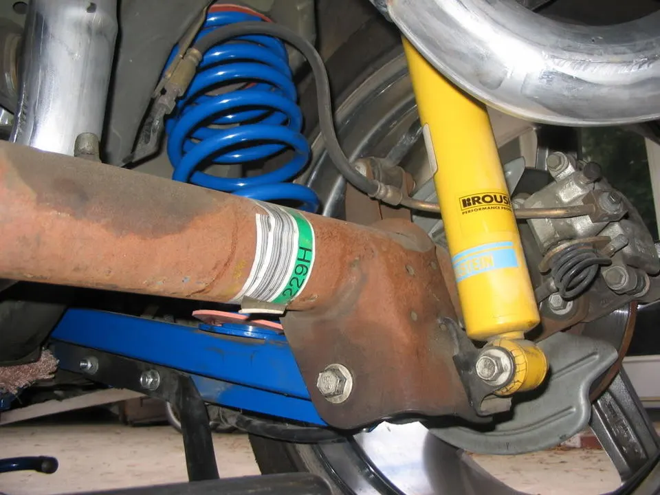

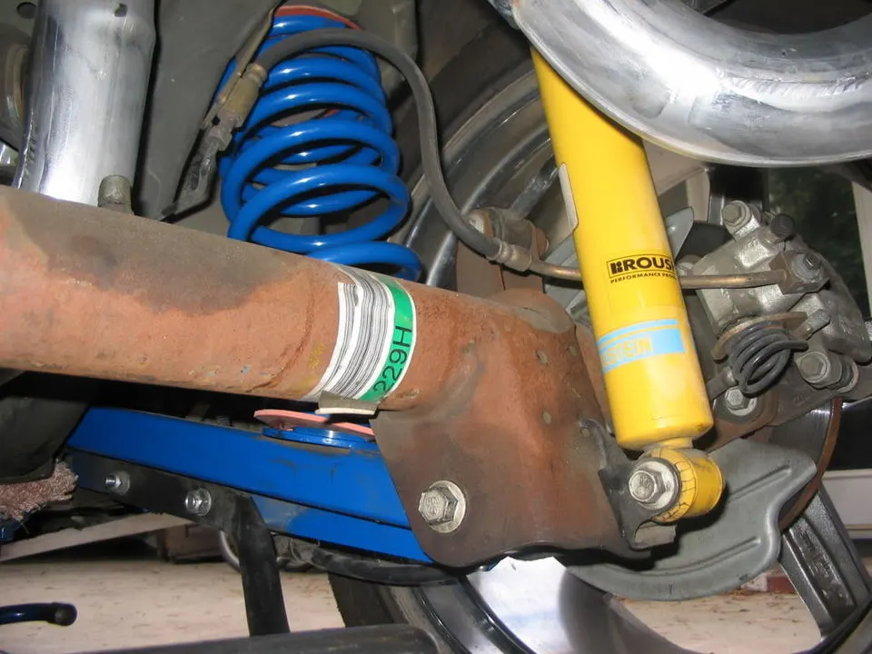

I just did mine a couple weeks ago. Except, I made new isolators out of 1/8 inch rubber. I was a little concerned with the metal to metal contact in the long run of the car...that's the only reason I did it. It seems to have worked great and I haven't heard a noise...H&R supersports...
You can kinda see the isolator in this picture...it's that orange rubber between the spring and the lower control arm.(springs are not compressed in this picture)
