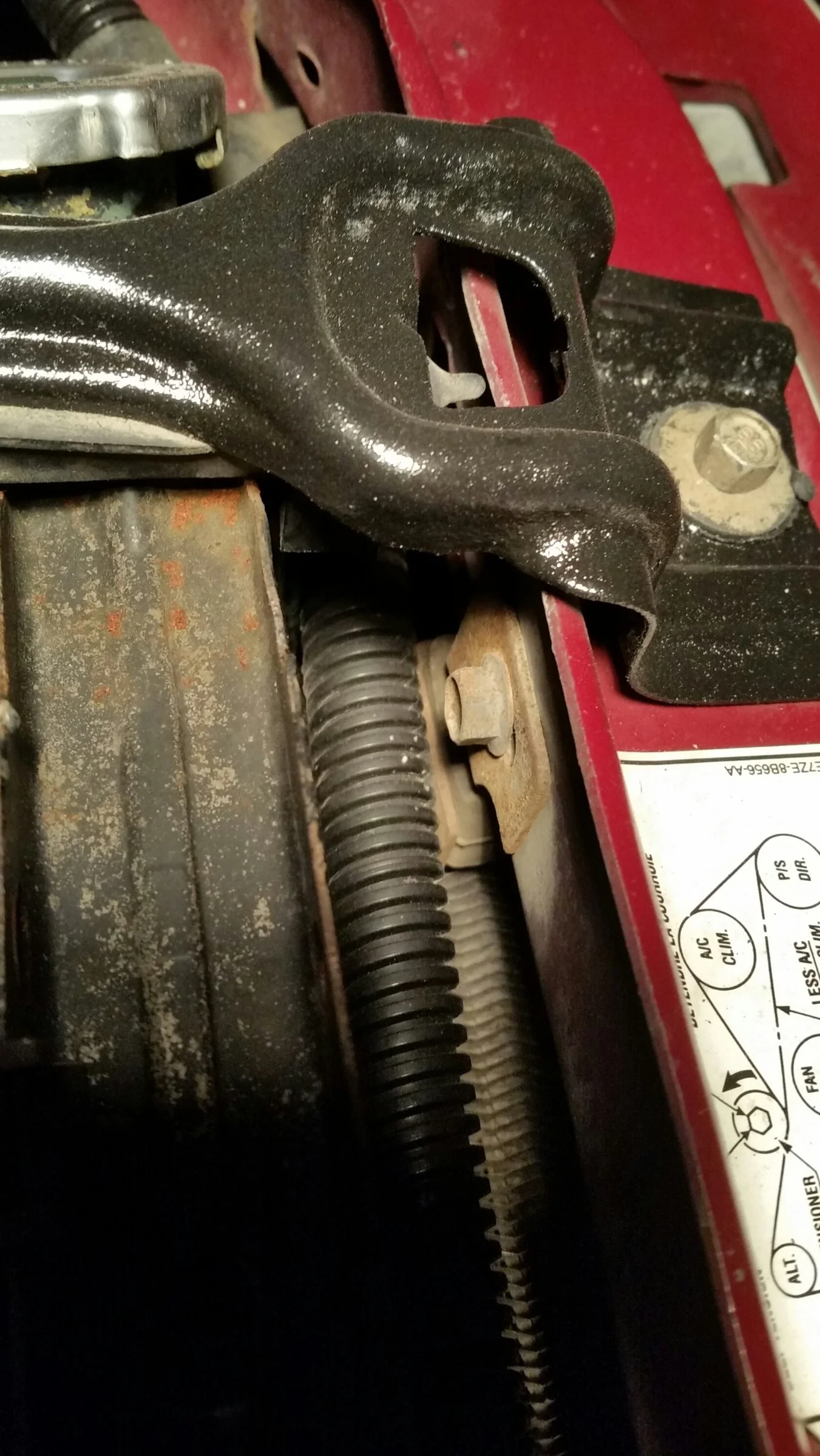

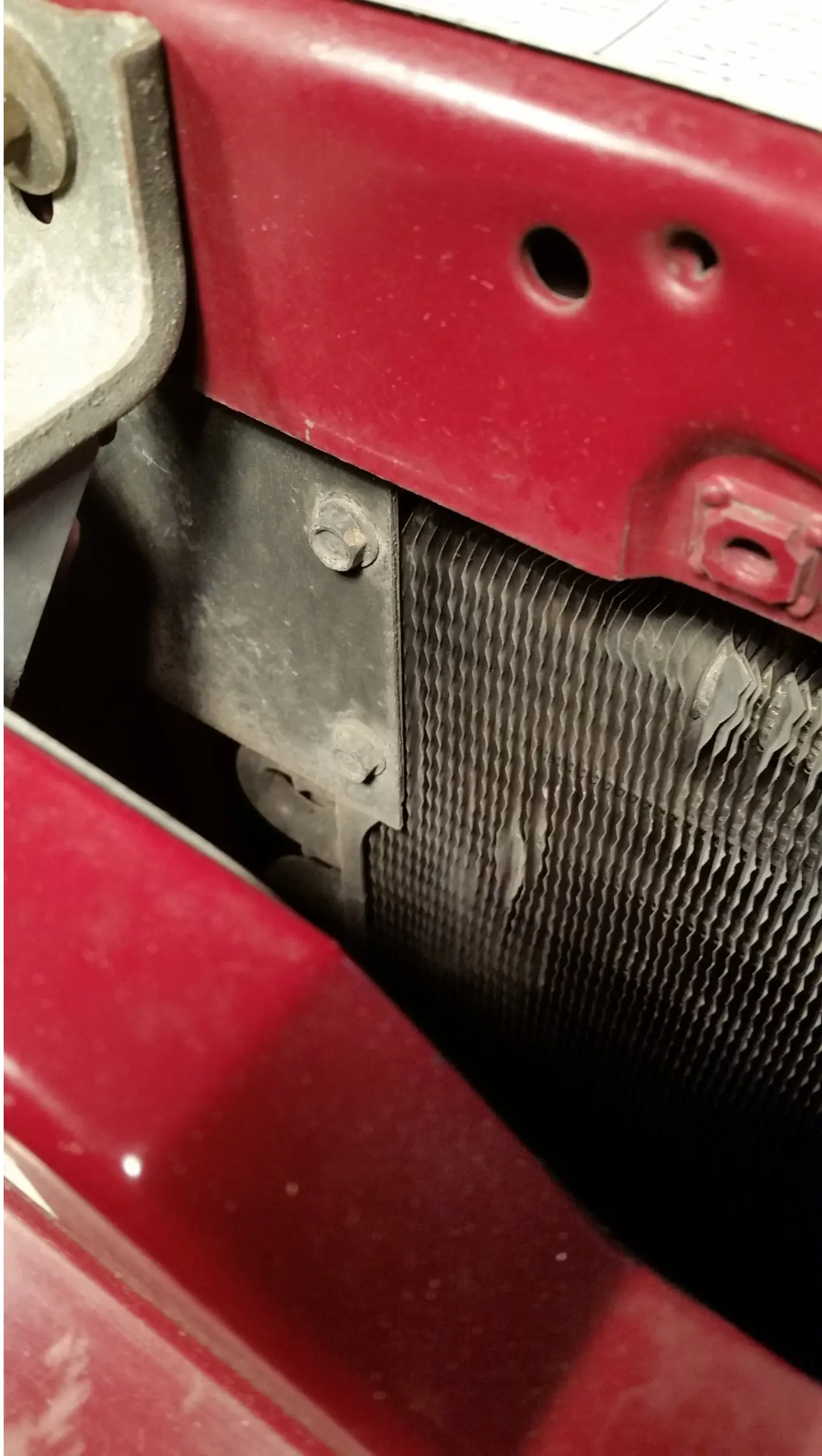

Well man, its damn hard to get a pic of them while holding a flood light in my garage. But here is what I was able to get.
Passenger side has two bolts through a flat bracket that wraps around the side of the condenser and attaches to the core support somewhere. I honestly could not see where though. Here is a pic of the two bolts holding the condenser to the bracket. This pic needs to be rotated right. Cant for the life of me figure it out. @Noobz347
On the driver's side upper, it is a tab that slides into a rubber mount on the condenser, and then bolts to the core support. You can see the rubber mount directly below the bolt head in this a pic.

Attempting to post some pics for ya, top mounts in above pics don't show the way the mount is placed, in his defence it's very hard to get a pic because of the wire harness and close proximity of the radiator. At the inside edge of rad mount look for a box opening on the rad side of core support, an ear gos in the box and lines up with the bolt hole, the rubber part of the braket fits under the rad support. The lower pic is a 86 but they are the same as my 89,
Those pics do help!
No wonder why I couldn't find where they went. I was trying to bolt them up from the front side where the hood latch is. Now that I see they bolt up from the radiator side, it all makes sense now! thank you!
