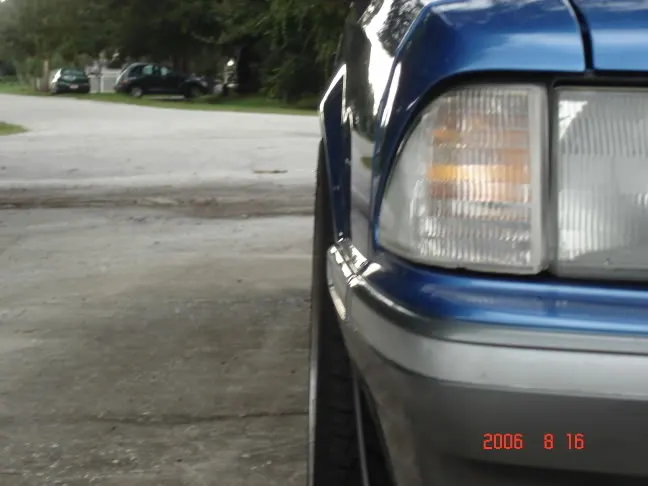

Alrighty guys I can pick up a set of 03 v6 front pbr calipers, spindles, lines and all for cheap. I am wondering how it will look with the stock width in the back with ranger axles/drums and 96 up having the 8mm wider on each side. Is it noticeable?? Thanks
you can leave the abs off. the 17x8 wheels will come up to the fender lip. I have 245/45/17's on mine and there is no rub at full lock. this has been covered a lot on corral. 9" wide rims start to stick out and alot of ppl think this looks bad. I dont have to pass an annual inspection so I dont particularly give a crap. 10"'s and you will have to beat in the inner fender and roll the lip a bit to get them to fit. I would post a pic of mine, but I have dial up.:(
fit up the back and see how it goes. you can always ditch or flip your quadshocks for more clearance.
I did some searching for you. I need an e-cookie for this one.
Thanks man! I am going to run a 1 inch or 3/4 inch spacer in the back to make them look more even. Yeah I also did the search on corral and found that 88GTstreetrod has 96+ spindles and I have seen his car in person and love the look with 17x8 bullits and a 1 inch spacer in the back(his old setup). I don't think I;ll have a prob with the 96+ spindles with the 17x8s
