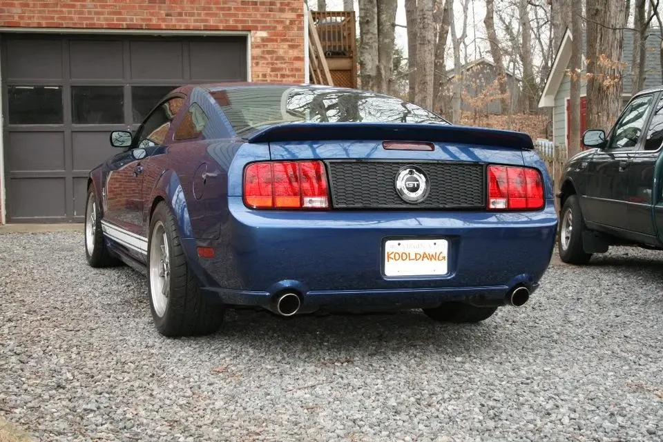

I have 295/45-18s on 18x10s in the rear with 1.5" drop and they aren't even close to rubbing. It looks pretty damn sweet:nice:

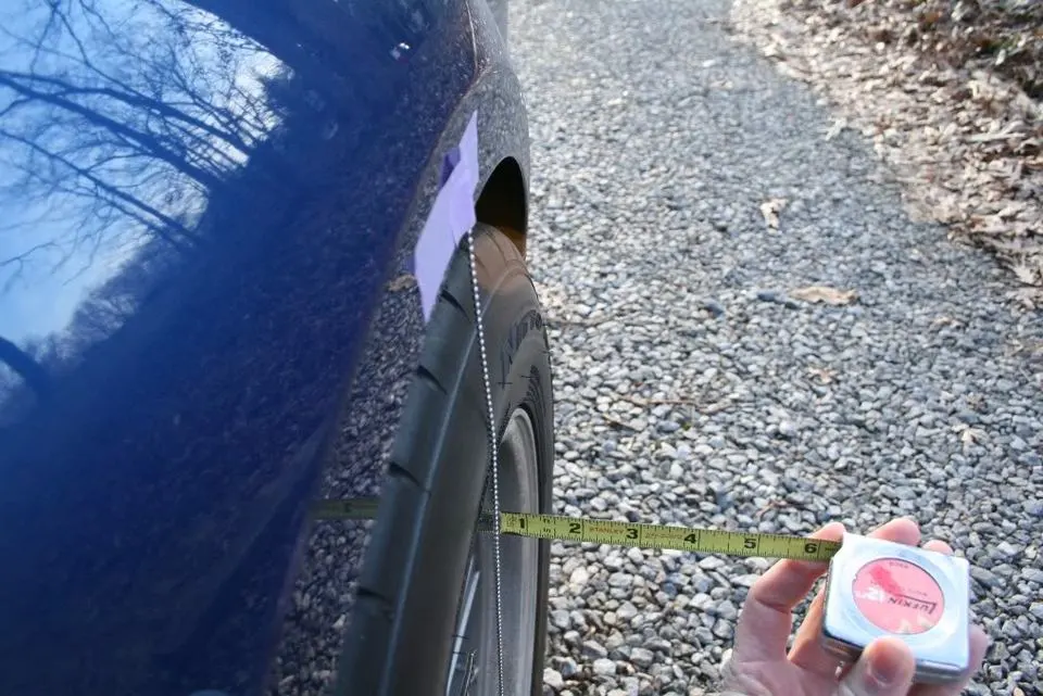

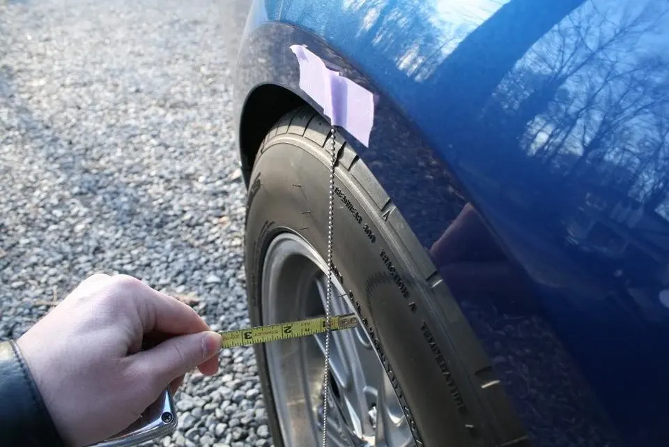

I measured the wheels this afternoon and I do need an adjustable panhard bar.
Here are the pics.
Passenger side
Driver side
