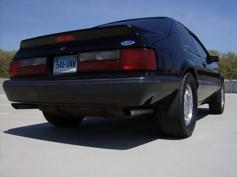

They will fit fine. My buddy has been through several sets of 275/50 bfgs on turbines on his gt. I had 275/50 bfgs on my 10 holes which are the same width (7"). Only thing I had to do to fit them was flip the quad shocks and massage the inner fender a tiny bit. I don't have any pics of his turbines but here's what mine looked like on the 10 holes. Can't believe how ****ty my car used to look haha.

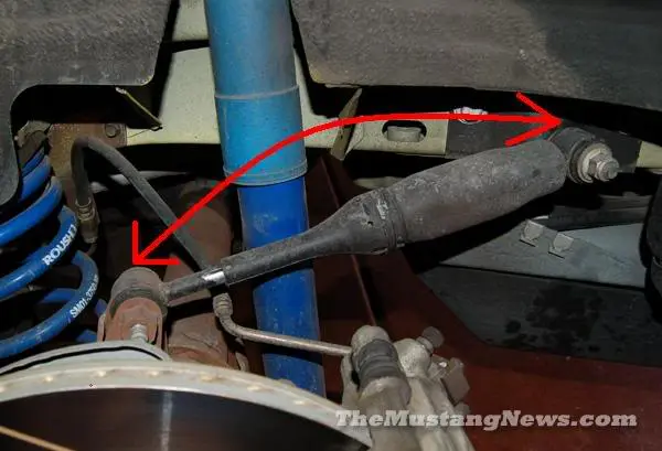

Thanks for the input guys and that photo is badass! LOL....Did you have to flip the shocks at stock ride height, or just to lower the car? and by flip them do you mean you switched right to left, or just front to back?

It's all stock rideheight. Bone stock rear suspension. Just remove the quad shock, flip it around the other way and reinstall it so that the narrow side is towards the rear of the car to give the tire more clearance.

thats a whole lot of tire on a little wheel. your wheels have a ghetto booty
