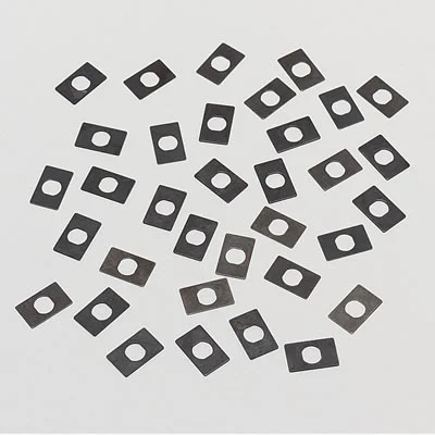

fyi, you may need these:
SUMMIT part # CRN-99170-1
link
http://store.summitracing.com/defau...rt=CRN-99170-1&autoview=sku&Ntk=KeywordSearch
I'm about to install 1.7's onto my car, and my brother just installed his, and told me I'd need a shim kit. I've never done this b4, but sounds like this may be your problem. It's a $10 kit.
Brand: Crane Cams
Product Line: Crane Rocker Arm Shim Kits
Rocker Arm Mounting Style: Pedestal
Shim Range (in): .030-.090 in.
Quantity: Sold as a set of 32.
Notes: To attain .090 in. reduced preload, you must stack the shims. Will not fit Ford FE engines.
