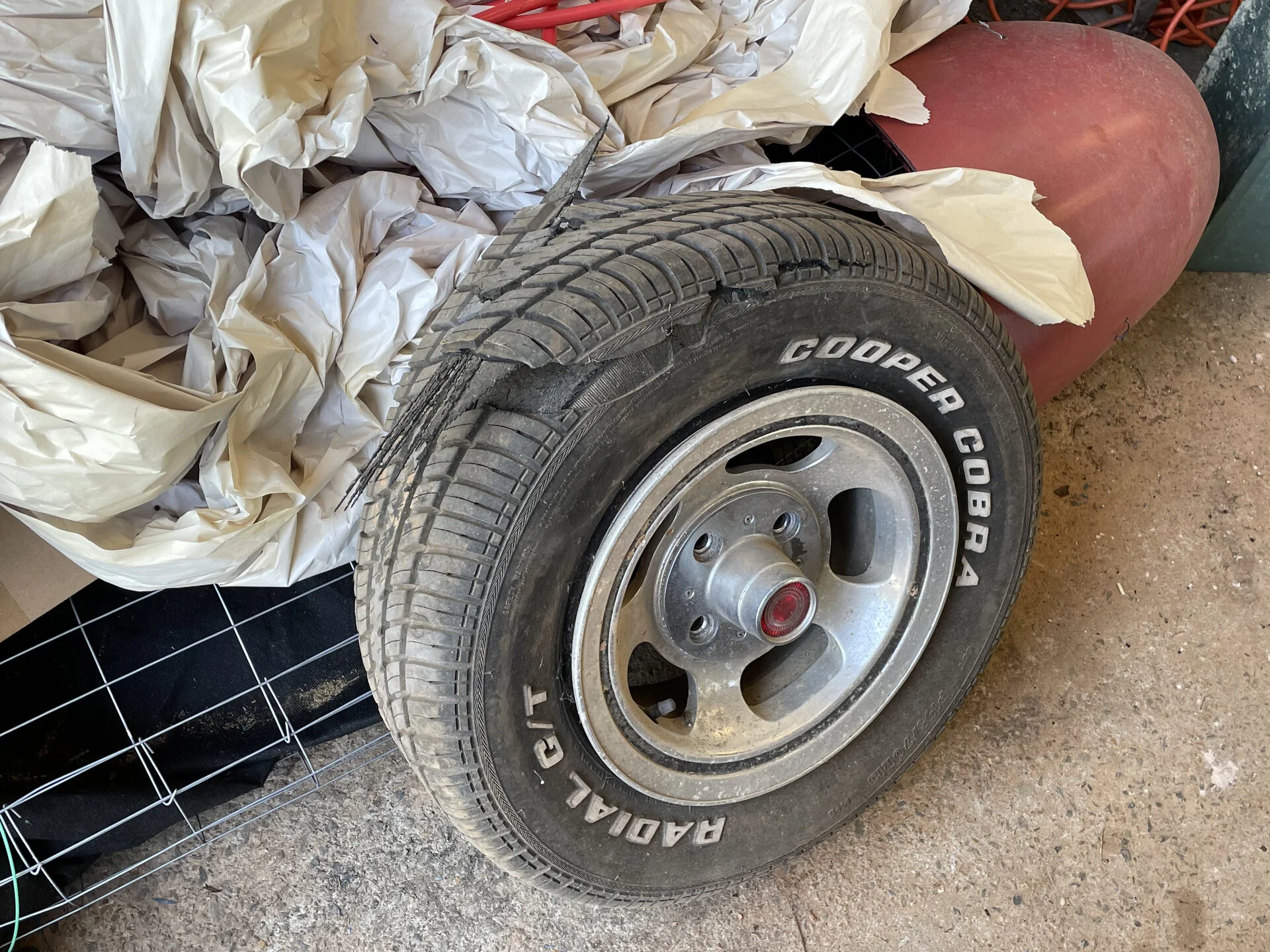

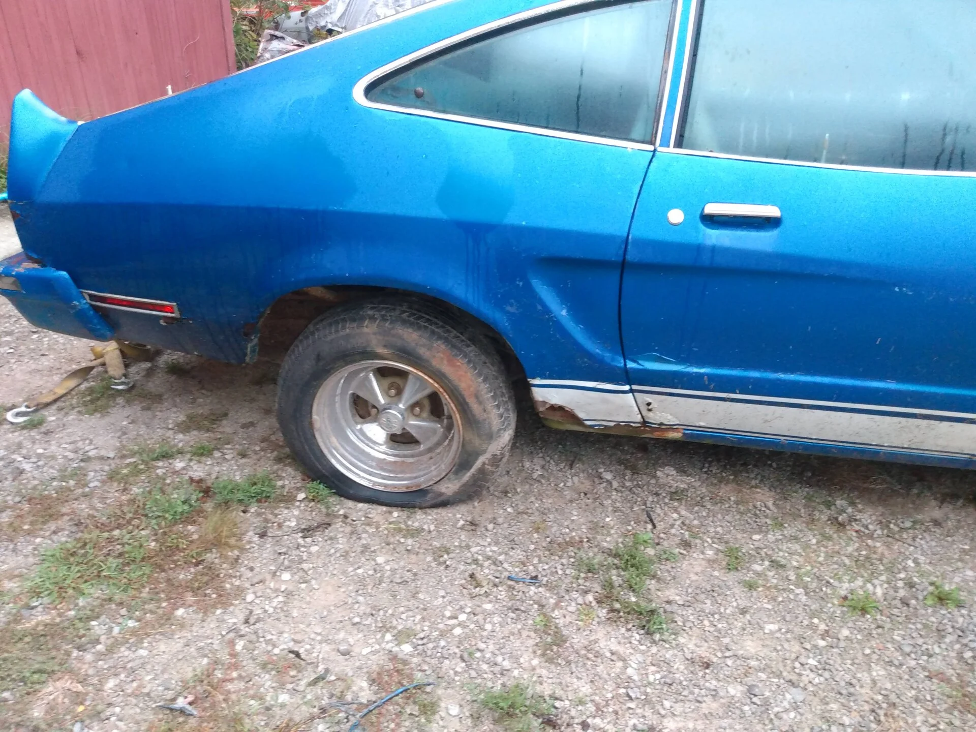

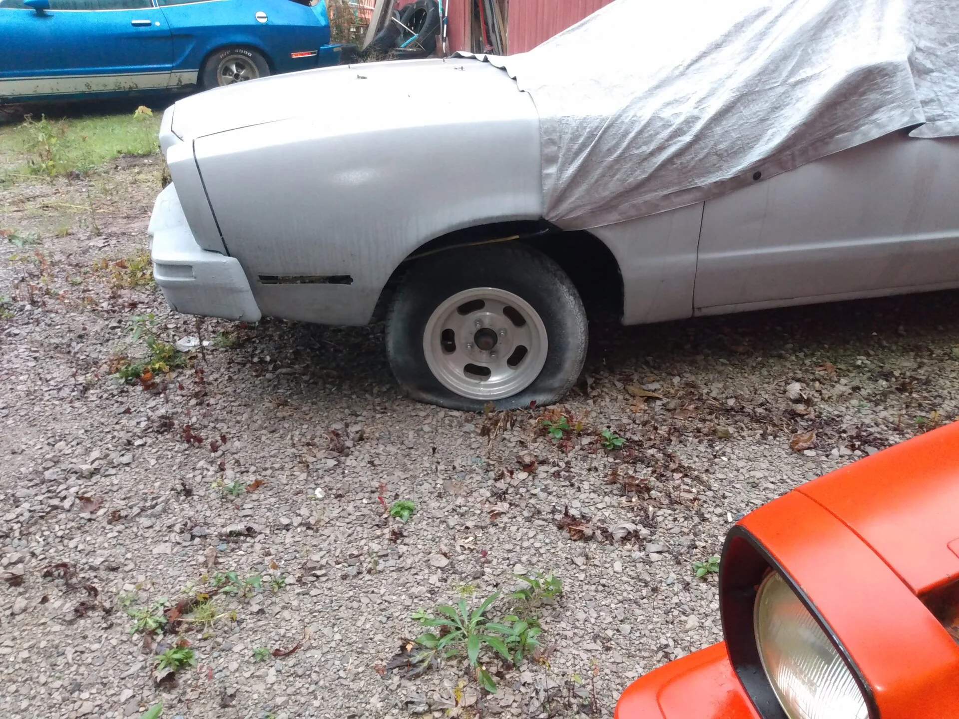

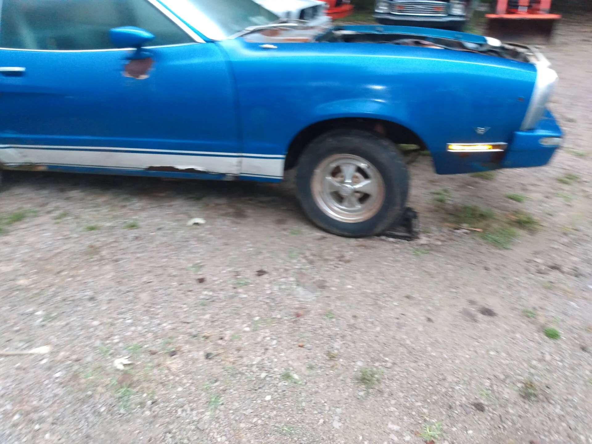

Work, yes. Well, Probably not. It was an optional tire for the II. Just short and narrow. One of the parts cars I picked up last year has them. They look tiny on it. It is probably the easiest way to get her mobile though. If your going 185/70 maybe do the 205/60 on the rear. They are about the same height and would fill the wheel wells better. Be leary of 205 on front though. The13's may be short enough but I run 205/60/15 on the front and they rub when turning onto an incline like a driveway or store apron that is raised. That is with the fender liner removed and a bfh massaging a couple spots.
Great photos. Thanks!
