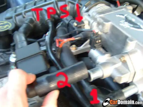

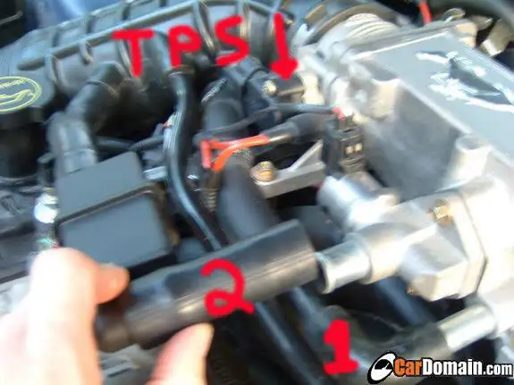

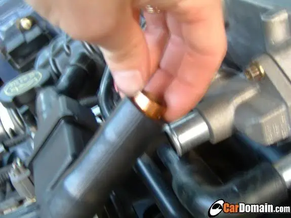

Stangrl kinda hit on this earlier but I had the same thing happen with my Accufab. People said just run it and the computer will learn. Never happened. The problem was in the picture. I had the #1 and #2 hoses swapped, stupid mistake but it was dark and I was in a hurry:D and that's the correct order in the picture.

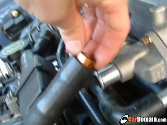

That kinda helped but still had the hanging idle. You look really cool sitting in traffic with the car at 1800RPM's. Everyone is like, "yeah your a real bada** dude" So to fix that I used the copper cap mod. Big thread on it somewhere. But stick a 10 cent copper cap in line #2 with a hole drilled in the middle. Runs perfect now. The smaller the hole the faster the idle will drop between shifts.
Try it before you take it into a shop. It's a possible cheap fix.:nice:

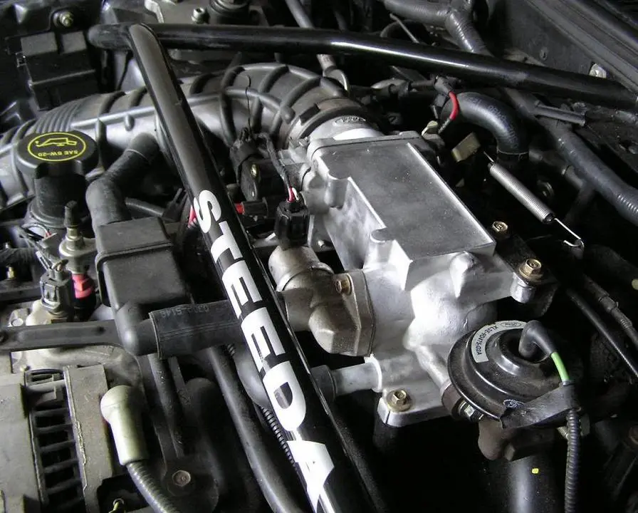

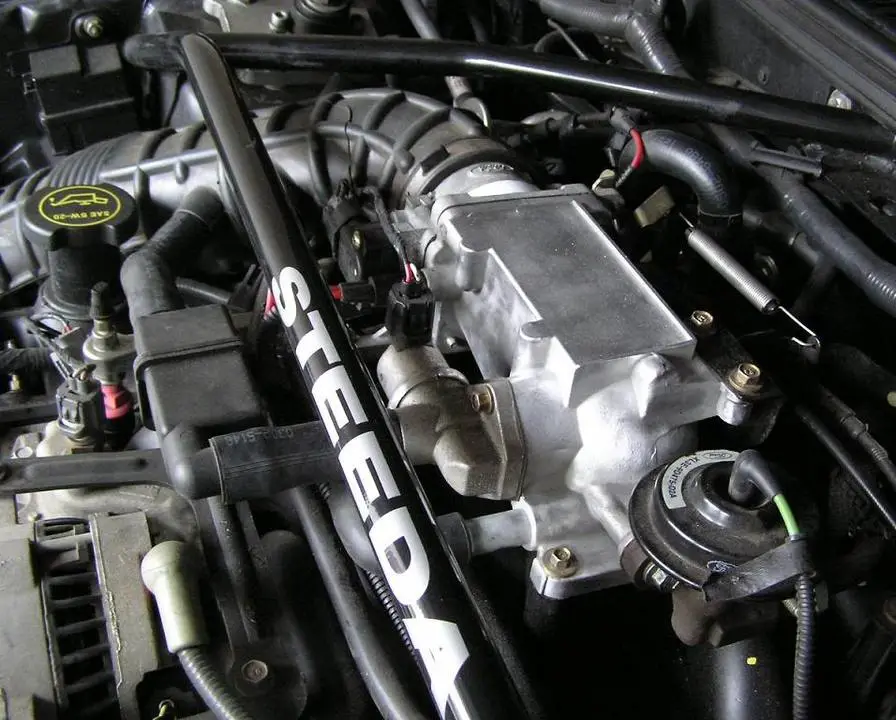

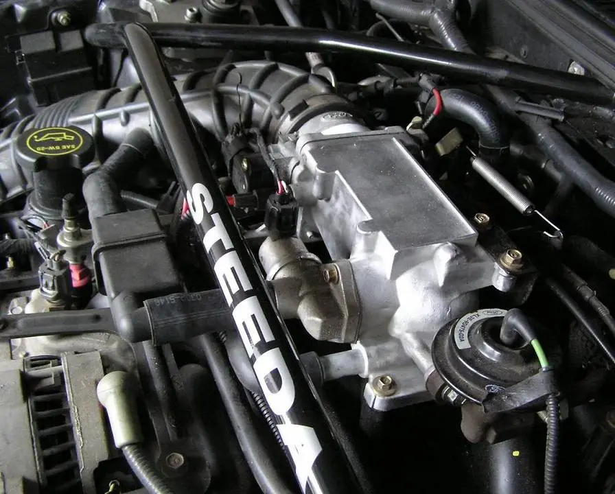

Here are some pics...see if you find anything wrong...
Picture of the ported intake:
See anything wrong?
My trusty DVOM (my only real diagnostic tool at my house):
Now i was reading in the BullitArchives online that there are wires going to the TPS that i can set my DVOM leads to and then check the voltage reading going in, and then loosen and wiggle the TPS accordingly to get it between .97-.99 volts. What wires do they want me to check here? And how would i go about checking them?
EDIT:
Ok here is another picture. In this picture below the Red Cirlcle indicates the 3 wires going into the TPS, im not sure of their colors because i wasn't paying attention and its hard to see from this picture. I read on a web page that 1 wire shoudl be a 5v Ref Source, another should be ground, and the 3rd being the throtlle voltage between .93-.99 (closed) and 4.25 or 5volts (WOT).
The Yellow Circle relates to Helty's write up on his T/B install, i believe he thought that THOSE 2 red wires were the throttle voltage. I'm pretty sure that is wrong though and the red circle i made over the TPS are the wires i want to use to check the TPS throttle voltage.
Here is the picture:
Now...from all i've read about this...all i have to do is find the throttle voltage wire from those 3 wires going into the TPS, and then with the KEY IN, ENGINE OFF loosen the TPS enough so i can wiggle the TPS and get it to read .99v and then tighten it back up??? Is that correct?
