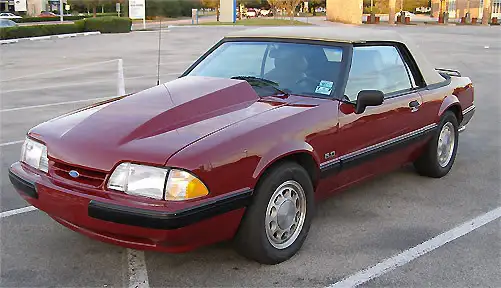

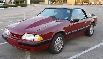

I have heard that the motor mounts from a convertible drops the engine around 3/4 of an inch. Is this ture. If not does anyone have any suggestions or know of where I can buy some mounts to dop the motor 3/4 to 1"? The hoos i have now is TOOOO tall for my liking and want to go back to the stocker.

Post a pic of it so we can gauge its gaudiness(sp?).:lol:

Like yourself my hood is needed functionality, not just for looks
