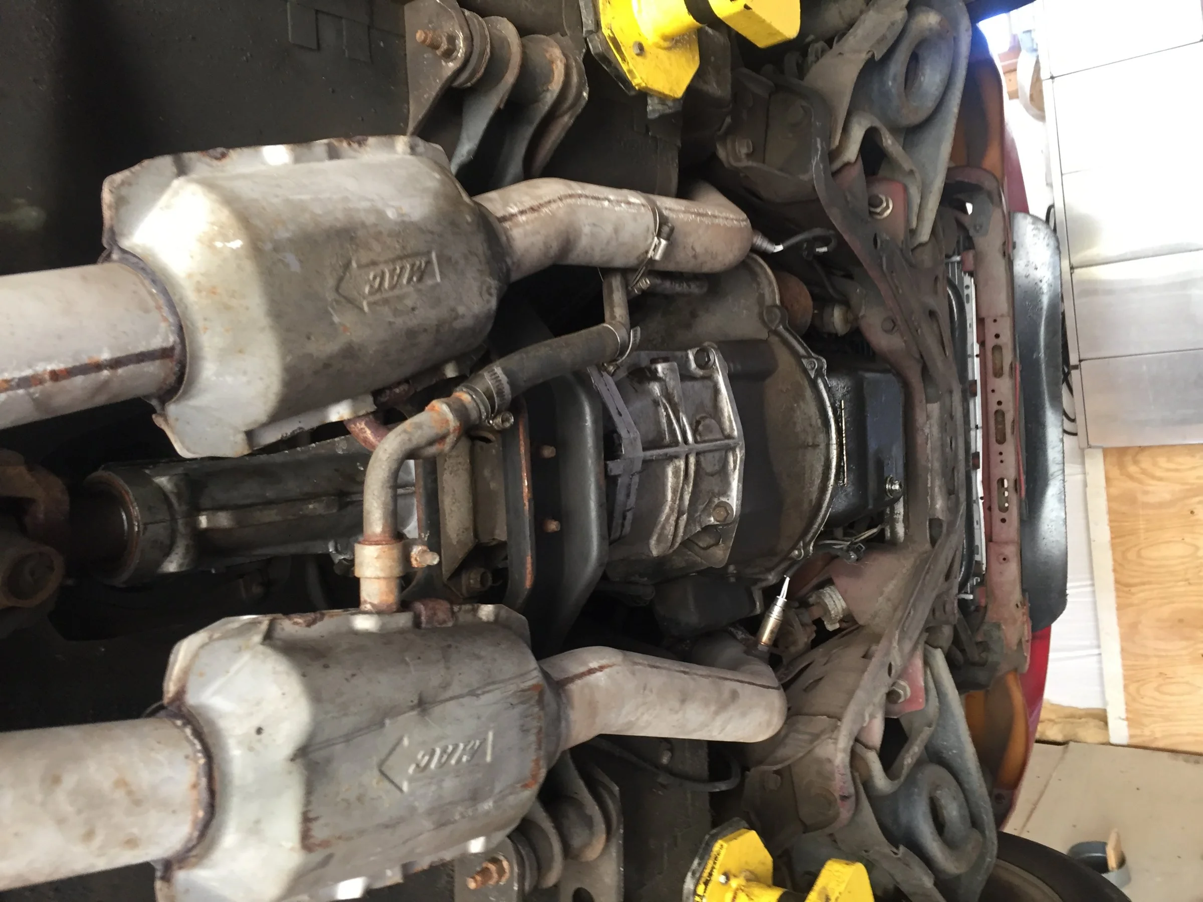

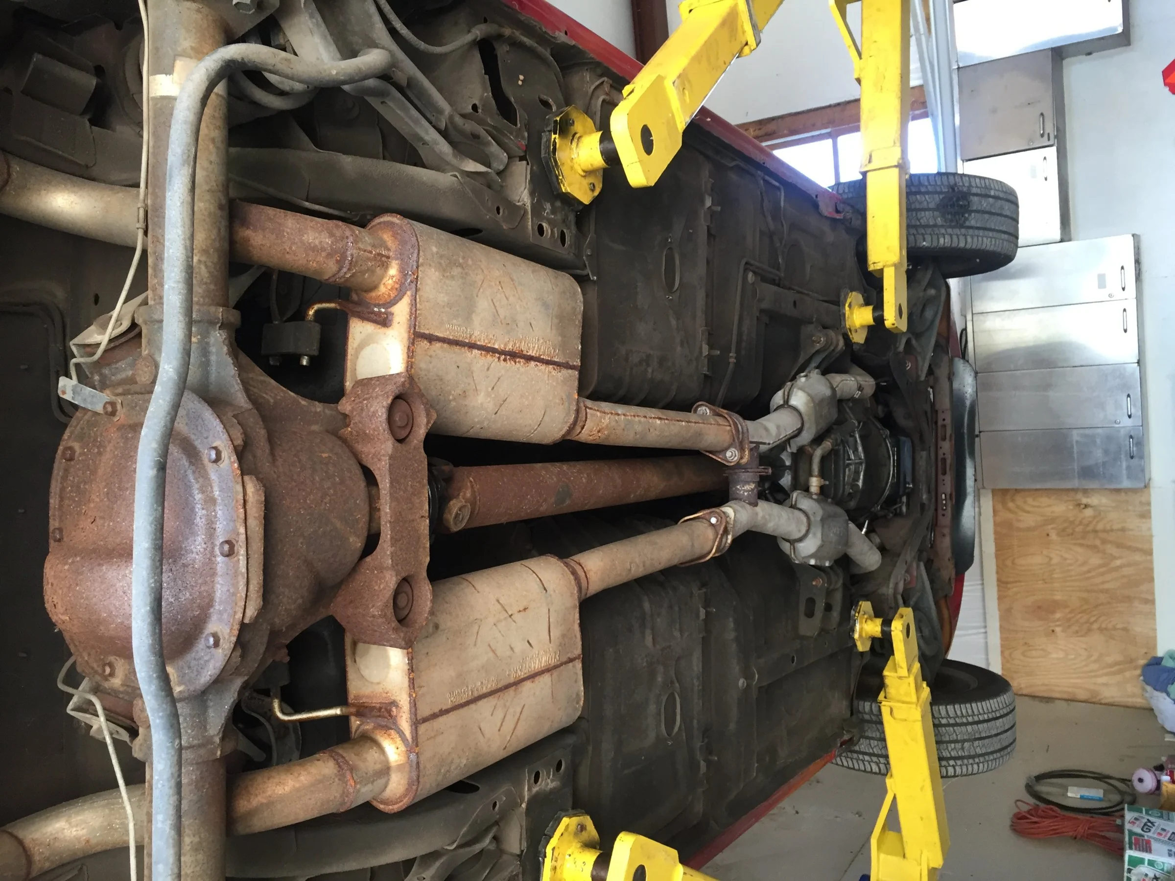

I just bought a '90 LX and it has a and older setup (probably from when it was first purchased) of the three MAC products: CAI, shorties, and catted H pipe.
A few questions:
1) If i leave the setup as is, is there any maintenance I should be doing to this setup (outside of CAI filter?)
2) The setup is pretty rusty, not corroded (heads mostly), Is this setup just junk?

If there's no leaks than no maintenance needed (except filter).
H-pipe looks to be in good shape cat-back has some rust but have seen a lot worse, run it!
Since you just bought it do the basics first, change all fluids, inspect brakes, inspect/replace spark plugs,cap,rotor etc.
Reactions: General karthief
mac tend to be on the lower end of quaiity for performance parts but if they are working properly then leave it as it

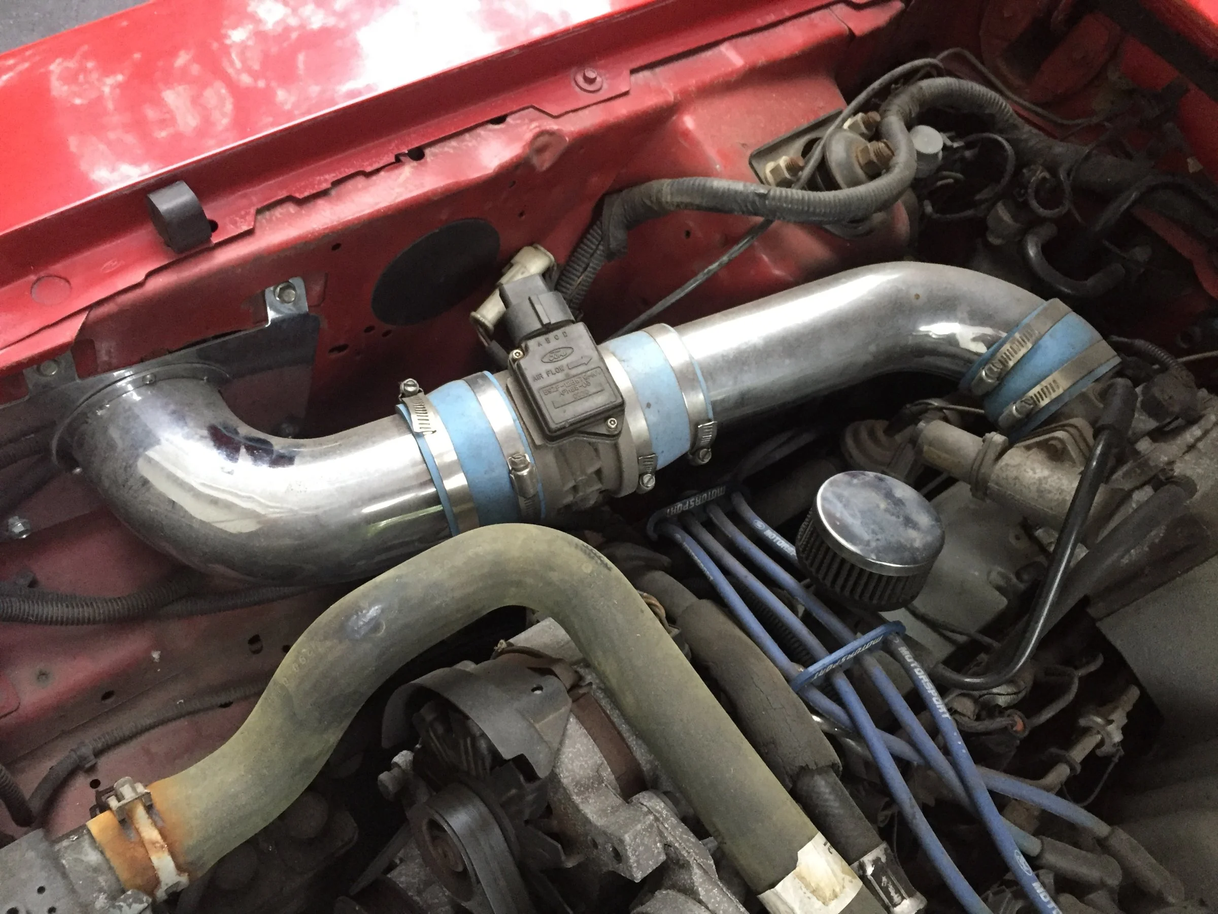

You do need to replace that open breather element with a closed one as you are sucking in unmetered air

Open breather = small air filter for oil?
#1 Why do you think someone would have put that breather there?
#2 What should i replace it with?
#3 Down side to unmetered air?
