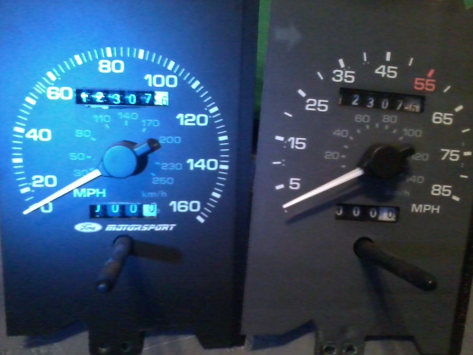

As the story goes, I was able to find a Ford motorsports 160mph speedometer, and I want to put my actual mileage on it without breaking it. My current 85mph (car is an '87) displays 12xxx miles, and my new 160mph unit is displaying 37xxx miles, and well, I don't want to have to leave it hooked up to a drill for a month to make it roll over again. Any ideas? Thanks.

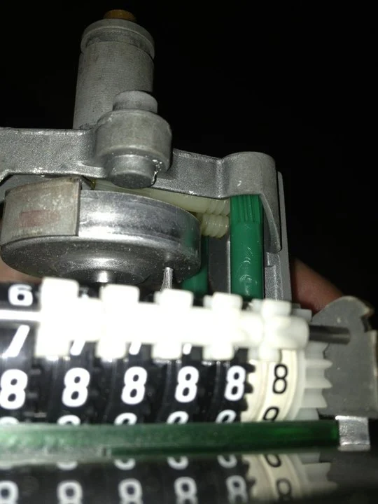

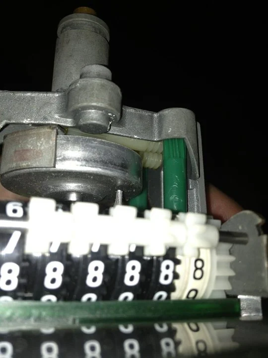

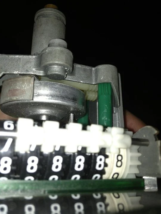

Quicker way to do it is to remove the idler pin on the backside of the odometer, and roll the numbers to where they should be and reinstall.
BUT, be careful of this method as the idler wheels need to install a certain way. If you do this., take pics in case you mess up the order.
So, I have an old 90-93 2.3 speedo that I thought I would play with to get some ideas. I am assuming the 87-89 isn't that different from the 90-93 speedo. Well, I found that the drill method (driving the hub that the speedo cable normally drives) is going to take FOREVER!!! Also, I found that driving it in reverse will not work, as when the 1/10's get to zero, the drive gear will stop driving the reel. What I did find is that you can remove a little copper stop/retainer on the worm gear that is driven from the speedo cable and disengage it from the worm gear that drives the reels. From there you can spin the shaft that drives the reels easily. I put a small gear from one of my R/C cars in my drill, wrapped it with a rubber band, and I can run up about 100 miles per 10 seconds with this method.:banana: Now I just hope the 87-89 speedos are the same design!!!:)

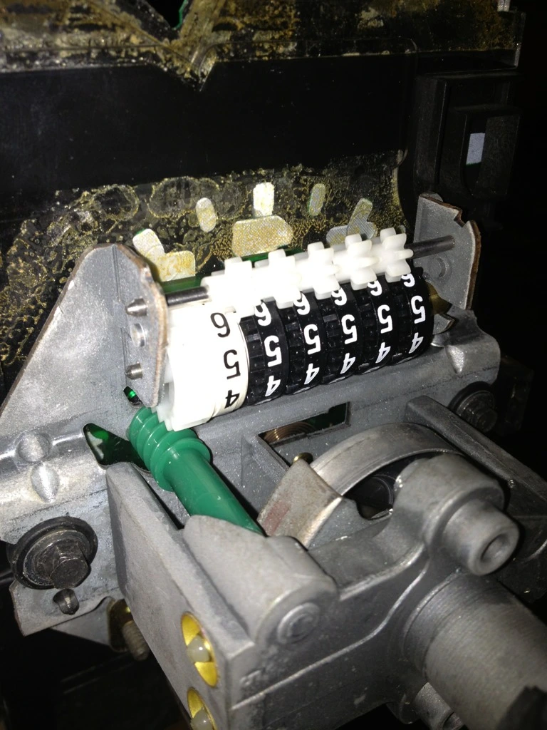

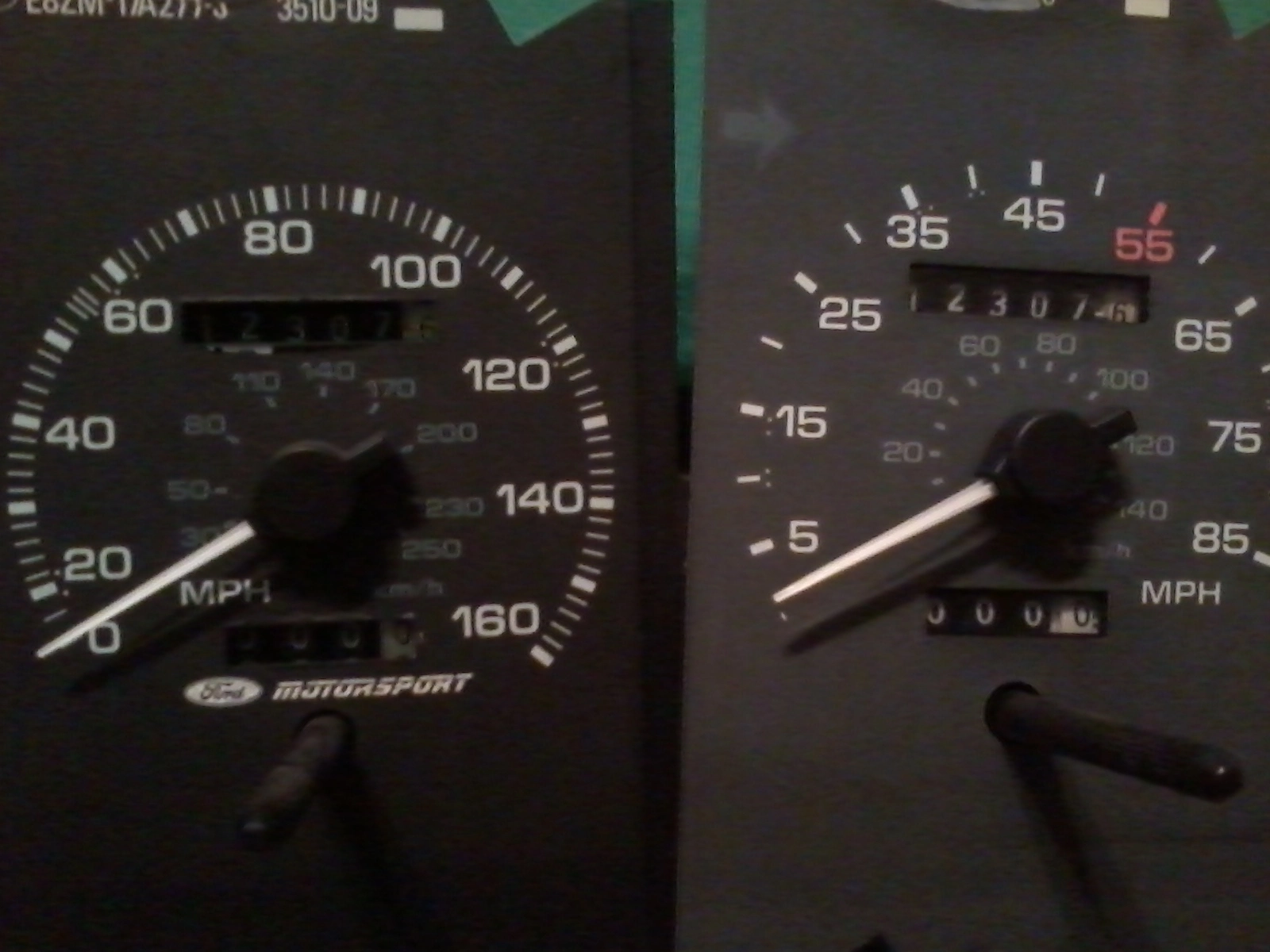

My '88s original speedo.
Swapped it for a 140.
Figured I'd reset it too while out

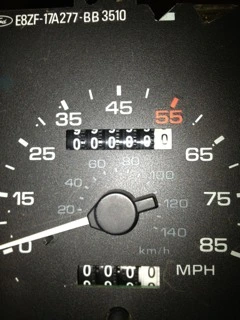

Sweet, yeah, that looks identical to the '90-'93 one I was playing with earlier. I also went ahead and pulled the idler pin and gears out and figured out how to reset it to 0. I wasn't comfortable messing with putting any other numbers in, but I did successfully reset it. That green gear/shaft is the one that I was talking about spinning with my drill. When I get my new speedo, I'll probably reset it to 0 and then run it up to match. Thanks for everyones help and input!!!:nice:
