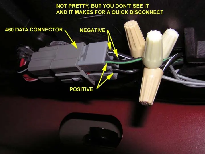

The Brown wires on the box are not needed, they are to ground the box to help eliminate ground loop, which can cause engine whine, but this would not cause it to not work, just to make sure you are tagged in a good place i would just grab a signal from the rear spkr. no point running it to the front you just need to make sure you are grabbing signal after that amp and not the signal from before it goes into the amp. also i would hook the white/black and grey/black to the same, and the white and gray also to there own to make sure that you are not running into a phase issue.
white + grey = positive rear spkr wire
white/black + grey/black = negative rear spkr wire
you should be able to follow the wires from the amp into the rear 460 pod, be careful you are not grabbing the lines for the tweeter, if you grab those you will get no bass.
I am at work atm when i get home i can take a picture of the mach pod with wire colors and such. i have a 460 pod in my living room right now lol.

k hopefully this helps.
that center harness is correct as long as you hook it up correctly
The red and black wires are the wires you need.
the red is your left the black is your right.
Red/whitestripe and black/whitestripe are the positive wires
solid red and solid black are you negative wires.
if those rear speakers are working this is no reason that your system shouldn't work unless you have something else that is wrong.
