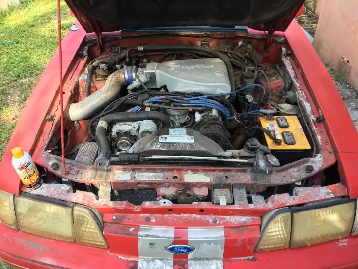

I currently have a 90 GT with a 347. It was running perfect when parked but has been sitting for years. What do I need to do to safely try and start it? I was going to pull some plugs and try to turn it over by hand and also give the gas a smell or drop the tank. Any advice?
Here is what I’d do.
1. New fuel. Jrichker has posted many times which wire in the diagnostic harness to jump to power the pump and drain it out the schrader valve in the engine bay.
2. inspect all hoses and wires and change oil and filters.
3. Make sure the brakes work!
4. Squirt some oil in the cylinders and turn it over without the plugs and the coil unplugged, and a rag in front of each spark plug hole to pre oil.
5. Put new plugs and wires in, plug in the coil, fire it up.
6. Or 4.5, check timing.

Thank you. I popped the gas cap and and filler door and smelled a faint smell of gas. My next plan is to drop the tank for inspection or stick in a siphon for a sample. I also pulled a plug which looked new along with checking the oil and that also looked good.
I am surprised no one found something important I missed! Whoo Hoo!
My theory on oil - It’s been a long time since the dinosaurs roamed the Middle East and Pennsylvania became the crude Dinoco bottles up. Popular Mechanics ran a mower for 5? seasons with the original oil then had it tested. The oil passed. It still had enough additives, and was high in one metal they thought from break in.
So IF the oil was fresh when the car was parked, I would mainly worry about rust or external contamination.
But, I do not count on the oil being fresh when parked. Changing the oil and the filter (did the glue, rubber seals, and filter media survive that long?) is a good way to make sure there is no coolant or metal in the oil system. Besides, once it’s running, you’ll have other things to do.
I'd change the oil. I'd probably change all the fluids, but thats just me. Draining the fuel out of the tank using the fuel pump is the easiest way to do it. I hate siphoning gas out of a tank. There is a good chance that it will start if it was running when parked. Why was it parked for that long if nothing was wrong with it. If it doesn't start but will turn over I'd suggest following the cranks but won't start checklist.

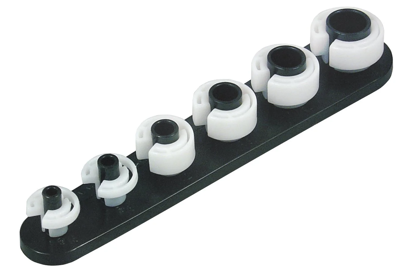

1.) Separate the pressure line (the one with the Schrader valve on it) using the fuel line tools.
Look in the A/C repair section for the fuel line tools. They look like little plastic top hats. You will need the 1/2" & 5/8" ones. The hat shaped section goes on facing the large part of the coupling. Then you press hard on the brim until it forces the sleeve into the coupling and releases the spring. You may need someone to pull on the line while you press on the coupling.
