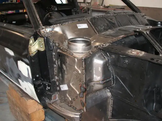

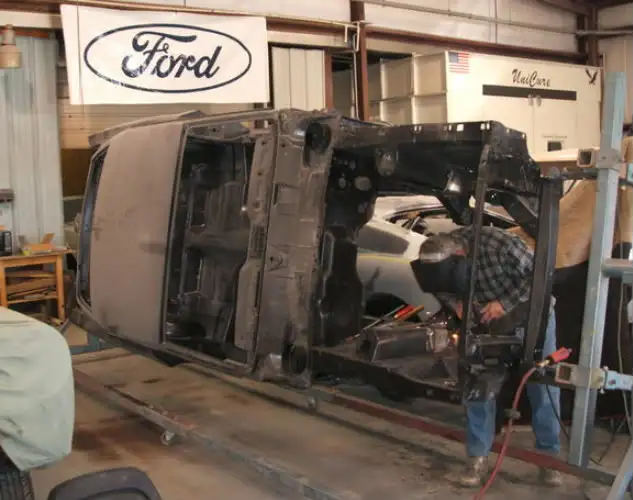

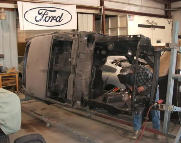

My "project" went from paint job to "didn't know that was behind the fender" to full rotisserie pretty quickly. Think of all the rust and damage you don't see. It's not a hole, it's a hobby. What kind of budget are you talking about?

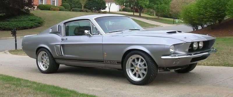

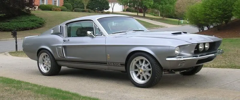

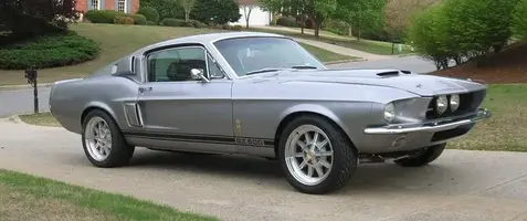

I started with a pretty clean stocker and have somewhere around $21K in my car now, but a big chunk of that was the fiberglass stuff. I did everything myself, including paint and shopped for the best price with every single purchase. It can be done for $20k, but you need to be careful and don't get carried away with buying stuff. A freind had his coupe painted and by the time the bodyshop was done replacing panels (doors, rear quarters, hood, trunk, taillight panel) and painting, he had over $17K in paint and bodywork alone. The last time I talked to him, he had about $42K in the thing! It sounds rediculous, but it happens in a hurry once you start buying stuff or paying people to do it for you. I'll try to dig up a pic of what I started with later, but here's what it looks like now

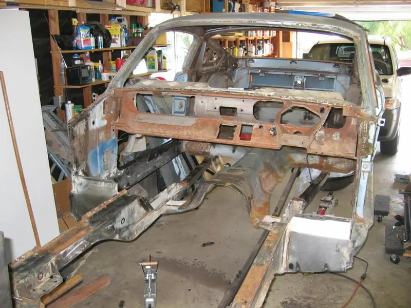

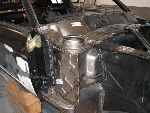

I had rust in nearly every panel except the roof. I probably could have paid more upfront for a rust free project and saved money in the long run. After a 3 year build I decided all future projects would start as rust free as possible. What ever rust you can see is just the tip of the iceburg.
