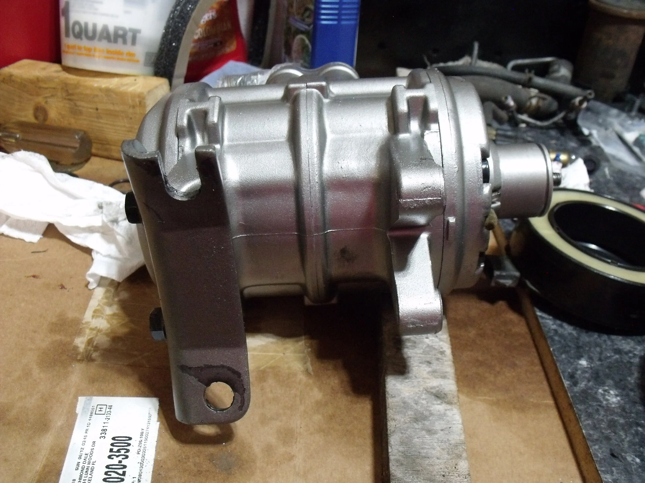

FOr the three lines you need:
More Information for FOUR SEASONS 55602
More Information for FOUR SEASONS 55278
More Information for FOUR SEASONS 55703
I would also make sure your evaporator and condenser are clean and in good condition and flushed.
If oyu need to rebuild the compressor, see here
Engine - Foxbody Mustang A/C Compressor Reseal - Nippon-Denso 6P148A
I plan on rebuilding a factory NipponDenso 6P148A Compressor. This thread will show details of that progress. It will be completed in stages, so I recommend clicking the watch button at the top right to get future updates as this won't be done all at once. Initial thread will be a bit all...
stangnet.com
Reactions: AeroCoupe
stangnet.com
These instructions helped out alot when I rebuilt ( or actually resealed) my compressor unit....
TY 5L5....
