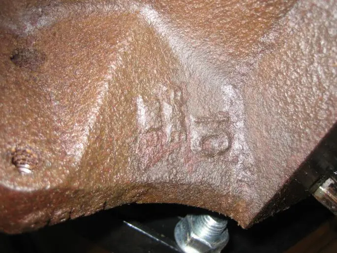

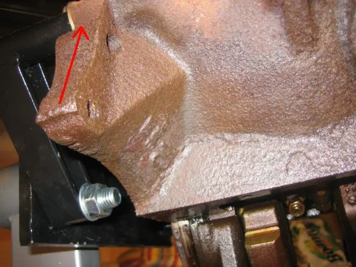

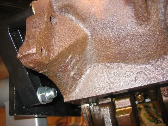

Well turns out I did need a wire wheel to get the rust off, and I am able to see some thing now.
When I first did some research, I found that picture of the block with the numbers on it, just like posted above, but when I realized that my bock didn't look like that, I assumed it could be located somewhere else. I continued to look on the internet, but found nothing like my block, so I assumed it was somewhere else. This is why I responded saying it does not appear to be there. If some one had said, 'well it doesn't have to look like that, it may look like bla bla bla' then I think this would have gone much smoother.
Now that I have located it, it seems quite hard to read. The number is 'letter,number,letter,letter' correct? I can make out F##E and it looks like the number is a 1. A 1991 block? would that be the 302 I hope I had?

Anyway, you don't have a 302 block if it's not where Joel said it would be. Post some pics and we'll be able to tell what it is most likely. My guess is a 4.0 V6.

Explorers didn't get a V8 until '96. Anything before then it's a 4.0L V6 only.
An engineering number ("casting number") will not tell you the model year and model the block came out of. Engineering numbers do not change from year to year, and they'used in more than one model line when possible.
A partial VIN is supposed to be stamped on the top-rear of 302 blocks, right behind where the intake would bolt down. It's stamped by hand and is very light, and sometimes covered with paint or rust. It will tell you the model year, assembly plant (which can help in determining the model line), and production sequence number. I've decoded several of these "serial numbers" elsewhere on the 'net.
