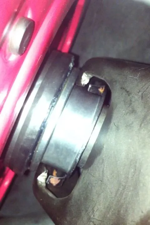

regardless of whether it's out of adjustment, I can already see the TOB coming apart. It HAS to come out... just don't know what I might have done wrong. all new stuff, fork and tob seemed to be in properly. maybe it went all out of whack when I was putting the transmission through it? anyway here's the inside and the damage. does the fork look too far away from the TOB in this pic?

Anyone have anything to say about what looks wrong in the picture above???
nothing looks wrong to me..
So on the bearing, the rubber doesn't look like it's coming apart?
any chance this problem is related in any way to the transmission itself? maybe something wrong on the input shaft side? something I didn't do right when I installed the new bearing retainer?
