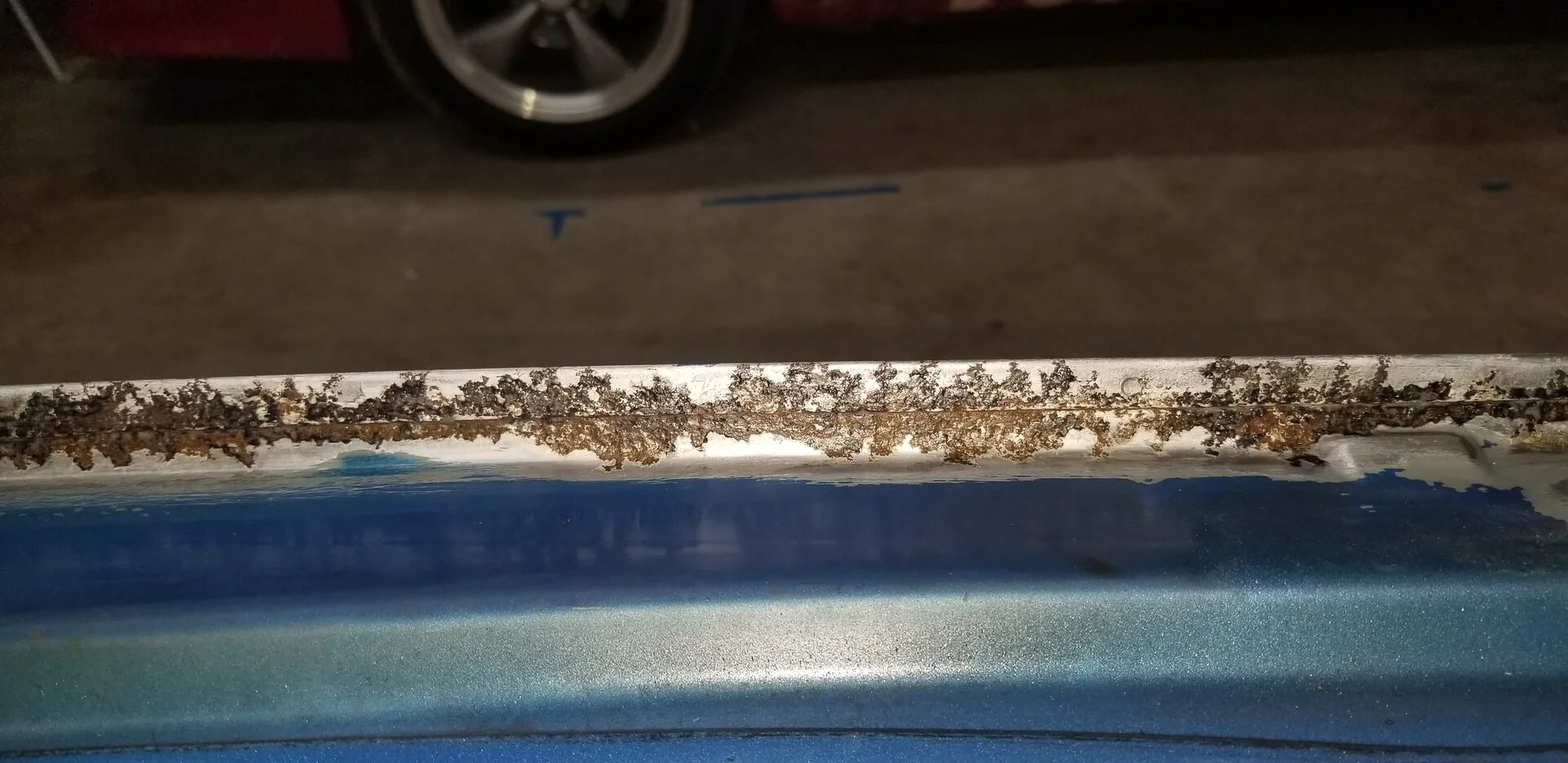

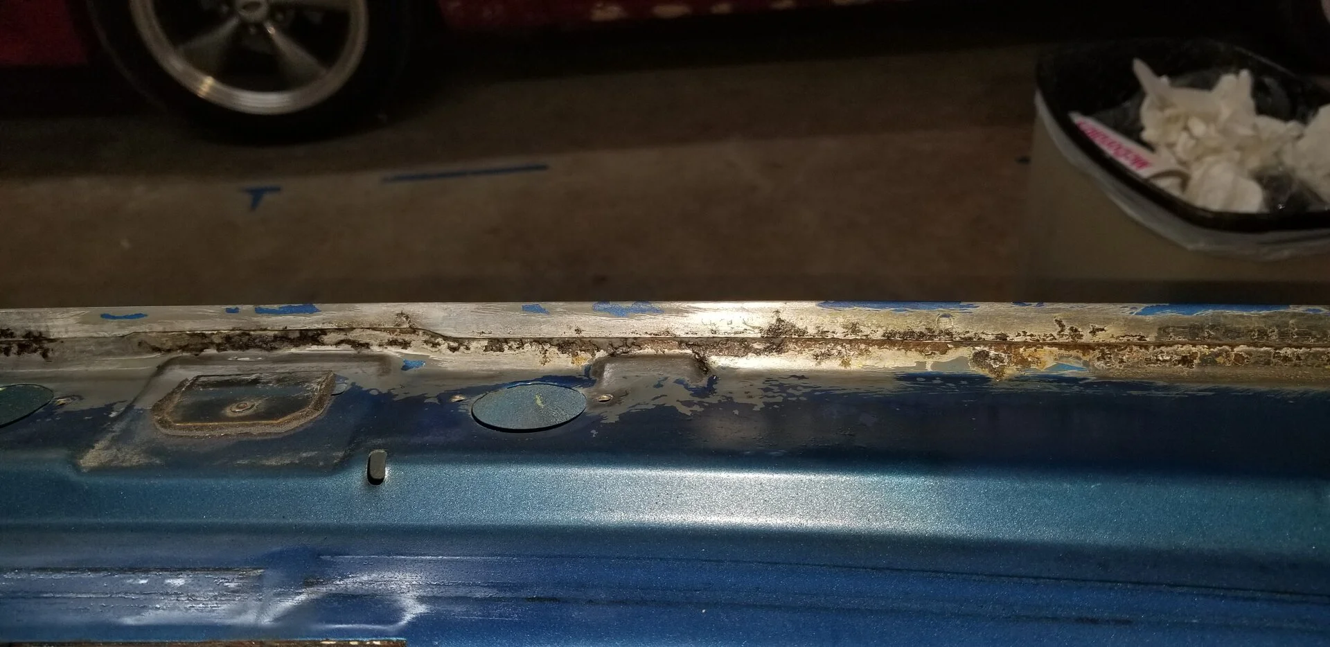

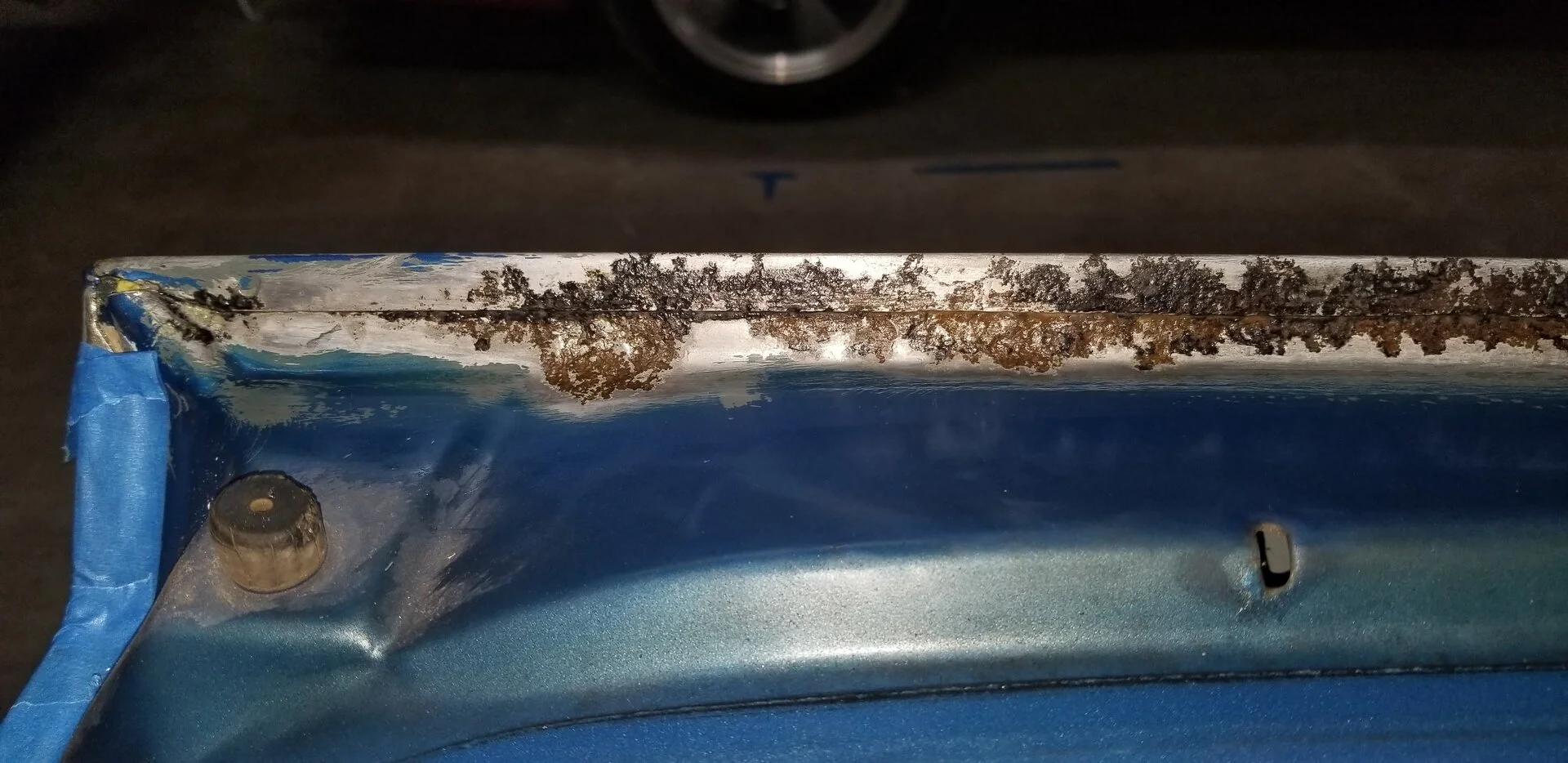

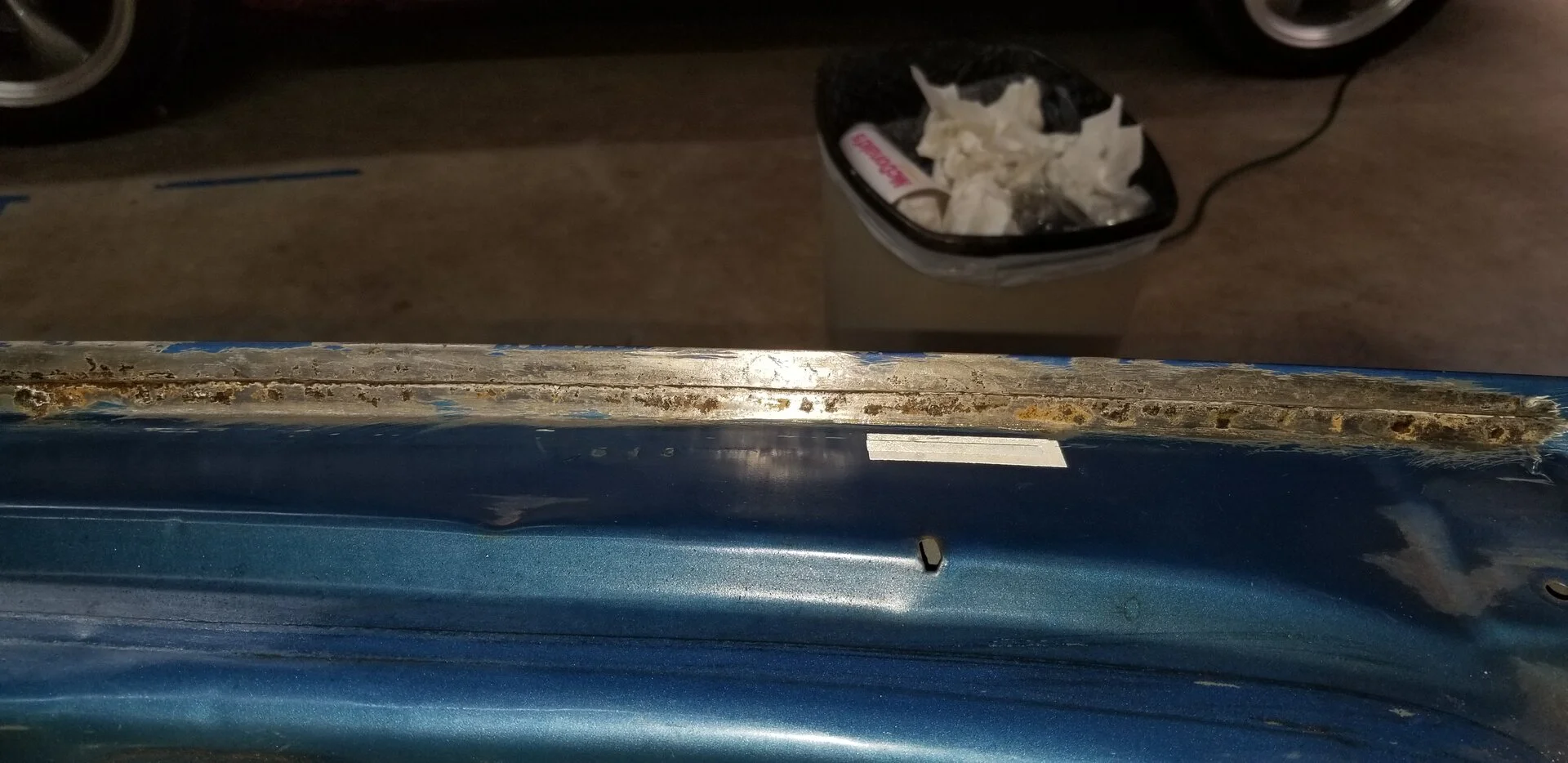

I got a new deck lid because I wanted the luggage rack and this one has some rust on the rear lip. I've taken a wire wheel to it and then used some rust converter. Is this good enough to prime, or should I treat it and continue to wire wheel/sand it more? Other suggestions? I'm going to prime it and it will remain like that for a while - a respray is quite a ways off.

How long do you want it to last? If it is still getting water inside, the cancer is nowhere near cured or put in remission here.

Which rust converter? The old car guys use Ospho or the less expensive Home Depot product, basically phosphoric acid, then after the rust is converted, neutralize it with water. Then hit it with the wire wheel one more time to get anything left behind, clean it thoroughly and prime with rust inhibitor like POR-15.

My personal opinion is this. That may not look terrible, but it is in a bad place due to the overlap in the metal. Without doing serious work on that it will always be prone to rust. You can get a new trunk lid for $275 from LMR. If you want the luggage rack you can easily measure and drill and mount the luggage rack to a new lid. It is only held on with rivets.

Cutting and welding would be the proper way.

Well this could get a lot more exciting. I'm not afraid to tackle it - I have time and a welder and the worst that could happen is I end up with scrap metal that can be used elsewhere.
How would one take this apart - it looks like it's spot welded in places and I guess drilling those out and then bending the lip back, or is there a better way?

Get another lid or go through the trouble/time to drill the spot welds separate the two and treat the rust, prime, spot weld it back together, add seam sealer and paint.
I'd get another lid.
