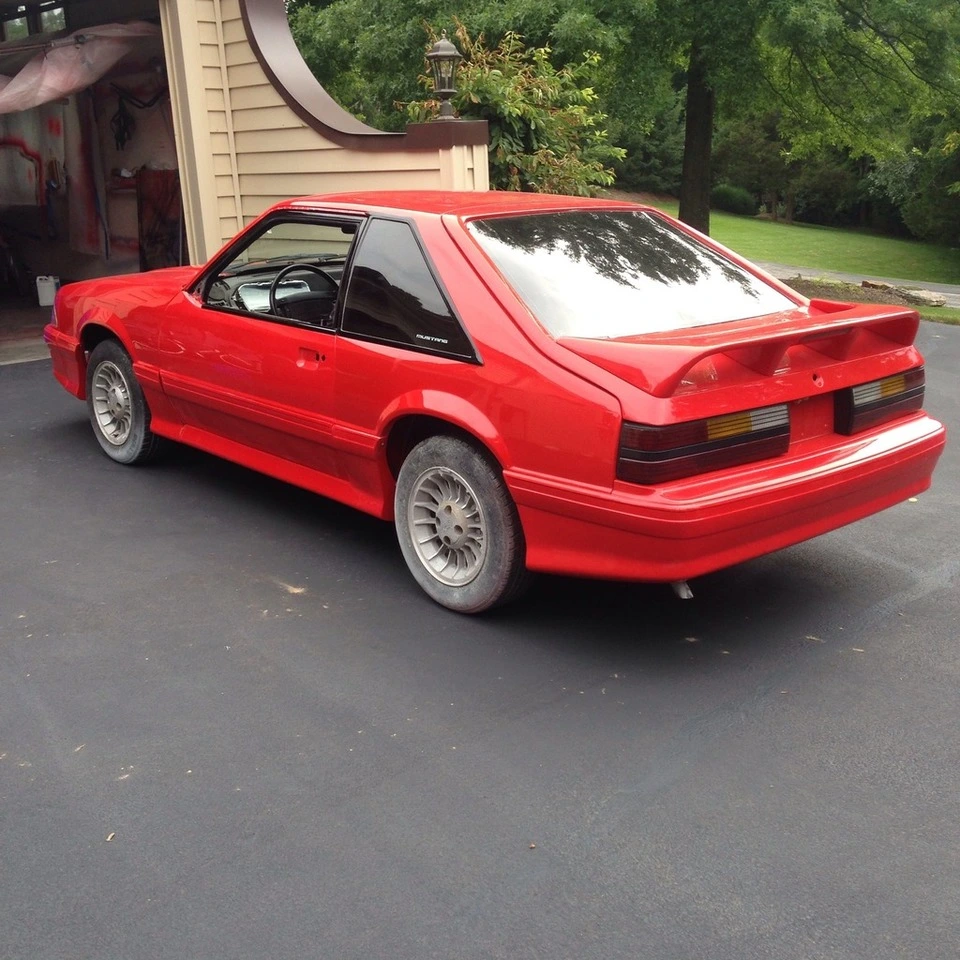

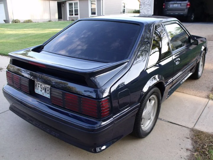

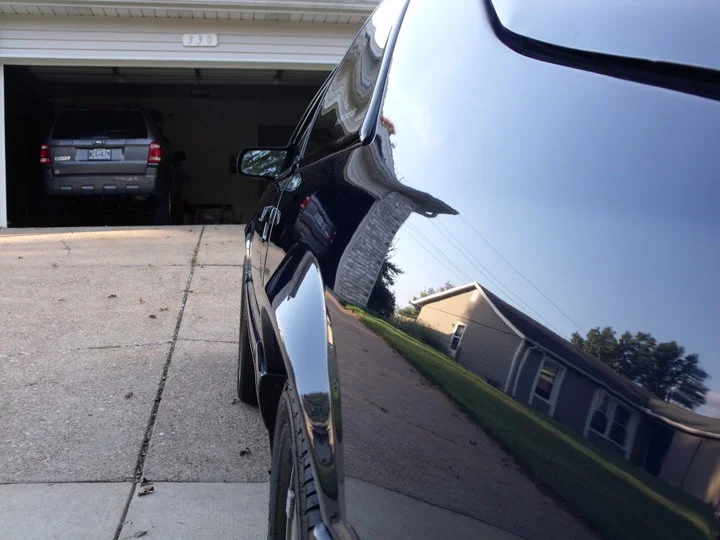

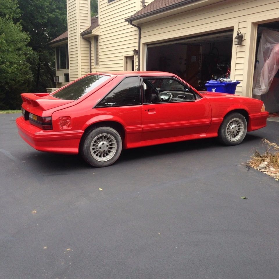

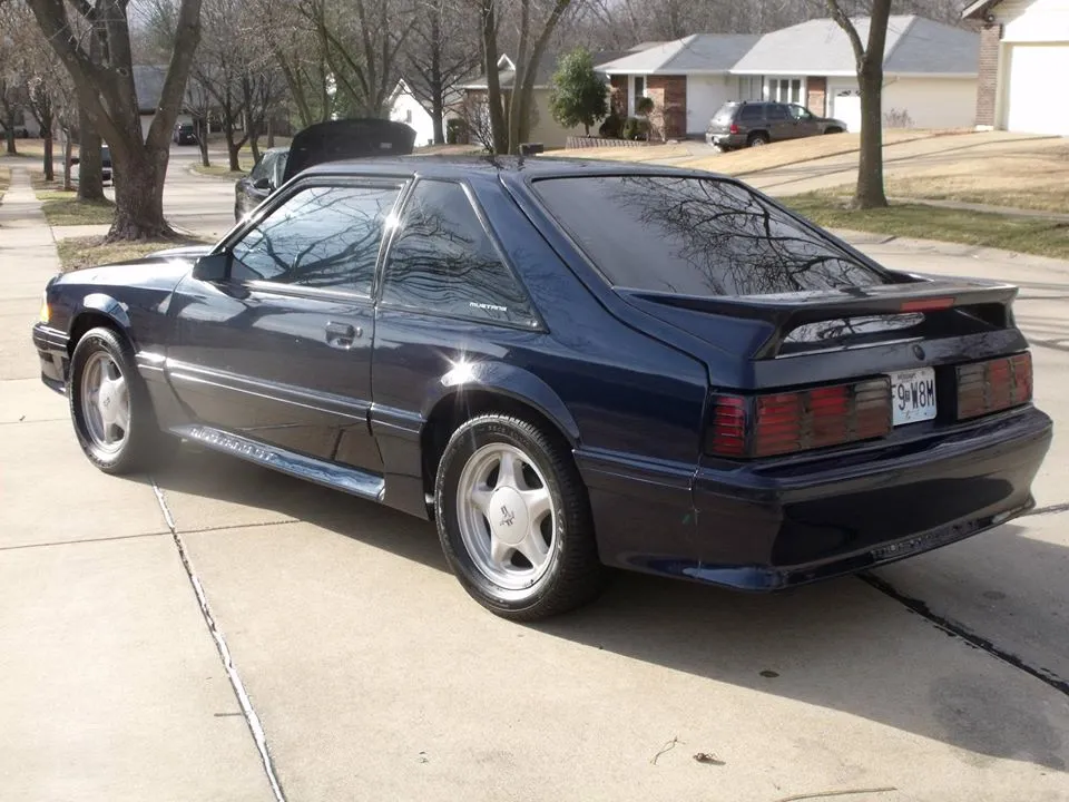

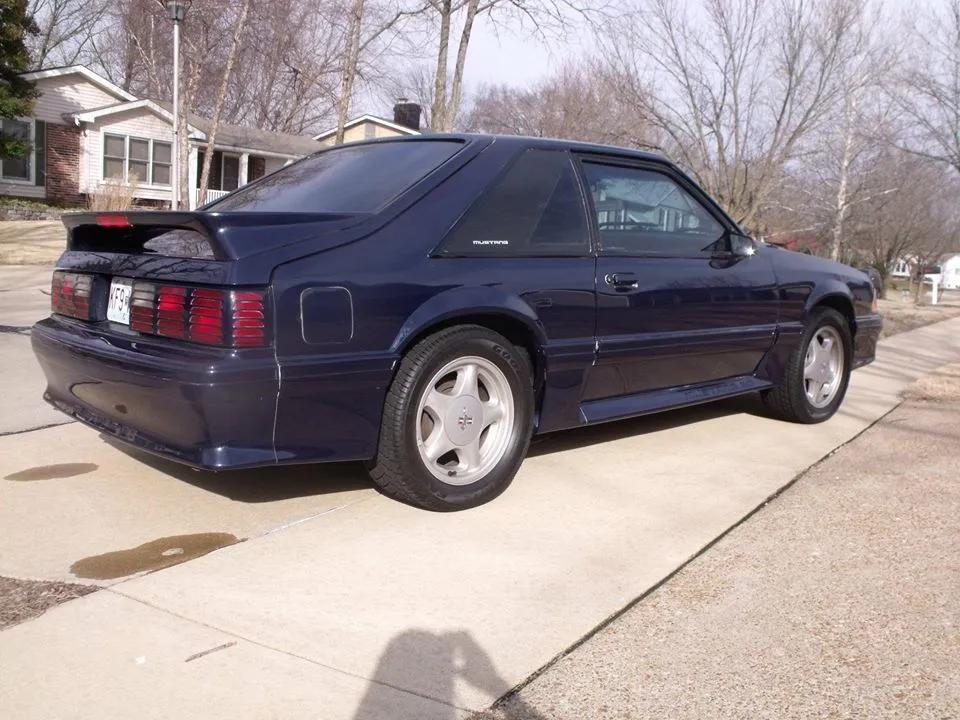

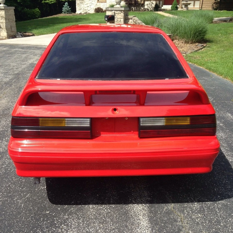

Here are a few pictures of my cars. I never really took pictures to "focus" on the hatch alone, but you will get an idea of fitment.
91 GT - HO Fibertrends
93 LX - Design concepts - This one has a fully finished underside. It is a bit heavier than the HO, but not significant for a street car. It is more similar to the Cervini's part as far as I can tell. As an aside, there was a rumor long ago that Design Concepts were cast off Cervini's parts that weren't up to Cervini's standards. I could never verify that, though.
Car is a WIP but they are the best pics I have at the moment.
Anyway, I didn't really want to hijack the thread, but I guess the takeaway is that Fiberglass parts can look okay if they are finished correctly and care is taken to get them to fit right. Also, I don't own Cervini's hatch, but the ground effects and rear bumper on this car are Cervini's products and I was happy with their fitment.

91TwighlightGT, thanks for the response! Given my luck with steel hatches, maybe this is an option for my car. One question: Can you use the gas struts on the fiberglass hatches? If not, what do you do to keep them up?

Unfortunately, you can’t use gas struts on them - at least, they don’t recommend it and I wouldn’t take a chance with it. The potential to damage the fiberglass by putting a heavy bending load on the center means that the gas struts are out.
I don’t have anything to hold mine up, although I have considered a prop rod of some sort before. If you are always getting in the trunk you may not prefer the fiberglass option.
