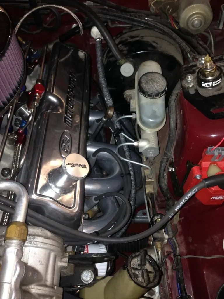

Coil is a coil. I put one on my T-Bird with a carb'd 351. Just got the EFI bracket and mounted it on the front side of the driver strut tower like an injected car. Keeps all the crap out of the way of the fogger system. Couple places to get it from:
Reactions: limp
I am going to do the same as the can coil will not fit with my new carburetor....
