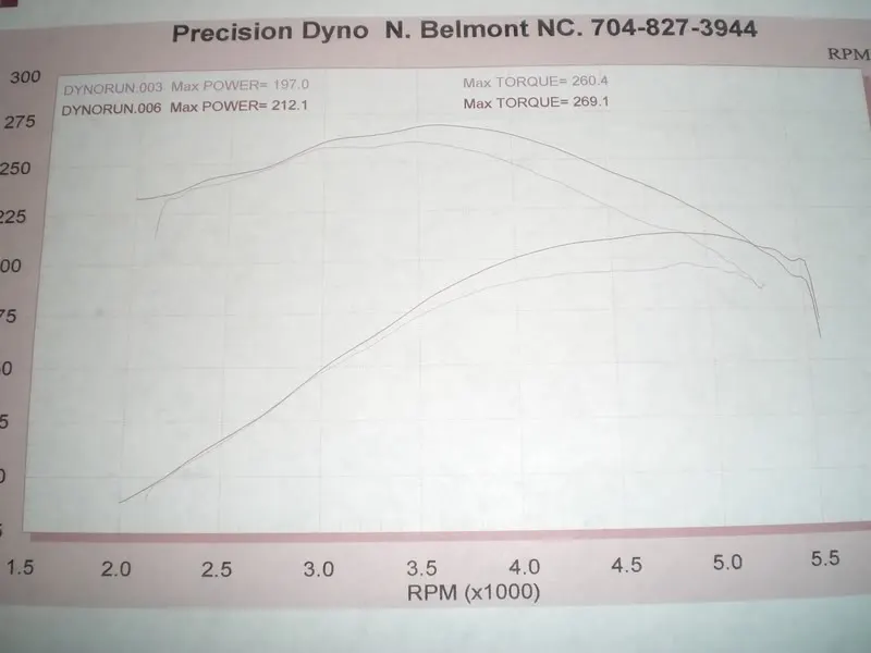

first dyno was with removed air silencer, k&n panel filter, 15degrees timing, and magnaflow catback.
second dyno was all of the above plus ford underdrive pulleys, offroad x pipe, and c&l 76mm maf with tube.
tq from 4000rpms and up was a avg of 20wtq and hp from 4200 and up was a avg of 14whp
and this is SAE corrected

thats impressive, and it suprises me, because i have those mods, and didn't really notice a lick of difference from stock in SOTP dynomometer! (but) i haven't noticed any real difference in ANY mod i've done. i was even dissapointed in my 2:73 to 3:73 gear swap.... yeah it is a little quicker now, but doesn't feel like its too far from bone stock even after all the mods in my sig.....
maybe my internal inertia switch is broken????
what are the rest of your mods???
