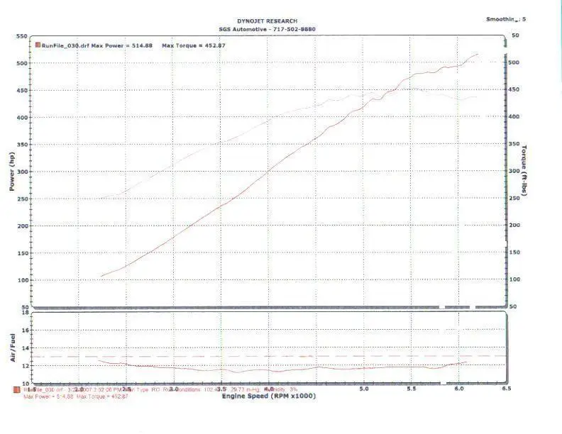

The final numbers are 514/452. I have a bad belt tensioner and the belt kept slipping so the graph looks a little jumpy. Dave my tuner said if I fix the tensioner and change the belt I should see 530 and 460-470TQ with no other changes. The belt has stretched so far that the tensioner was almost all the way out lol.

Over all pretty happy with the 80+ hp from my cams and headers since last tune. But it could have been close to a hundred if I had a better pulley set up.

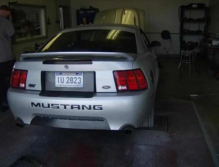

Here's my graph I'll try to do a better scan later tired now lol. :lol: Also a short vid from our crappy camera and a pic

Thanks guys I'm happy.
Vortech V1 514/452
MMR MOD 900 short block
2.8" 6rib pulley 13psi weak tensioner belt slipping pretty bad.
HP s292 Cams
stock heads intake and valve train
$400.00 ebay DIY FMIC set up
Mac LT's
Mac OR H-Pipe
Mac Catback
SCT BA2400 maf
42lb inj
cobra fuel pumps and tank
Kenne Belle boost A pump
180* thermostat
16* of timing
Pro product 75 mm TB
Pro products plenum
Afm 4" power pipe.
