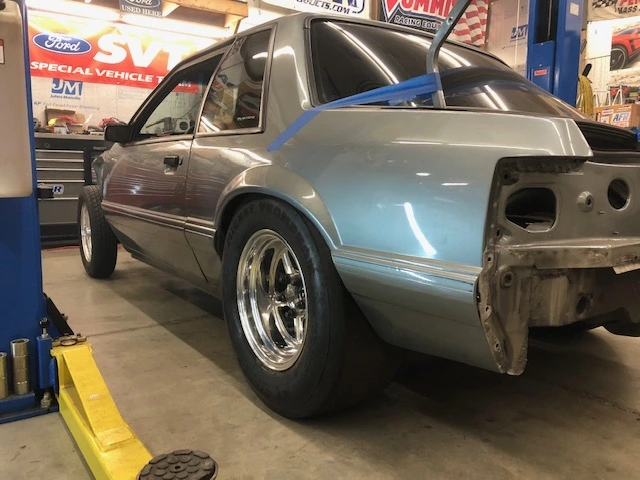

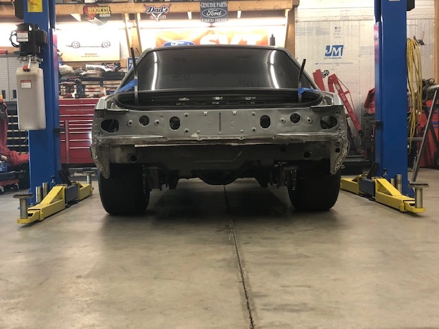

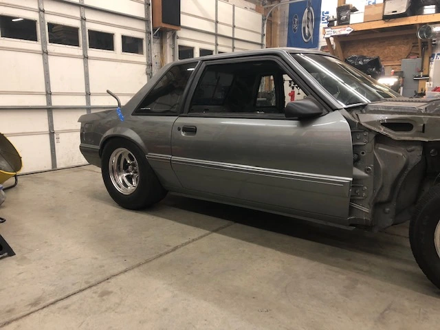

I've been stalking for a while, but finally decided to join. I've had a few Mustangs over the years, right now I'm about 2 years into a pretty slow, ground-up build on my street/strip 1993 coupe. This iteration of the build will have a N/A 363 and TKO 600, but the chassis and suspension will be ready for much more power. As of today the (slightly) narrowed Moser 9"is built, the wheel wells are cut and rails plated for mini tubs, and the suspension is mocked up for ride height and coil-over installation. The frame connectors and some of the 8.50 cage will have to be finished before the tubs are finally installed. With a little luck, I'll have it on the road sometime next fall.
