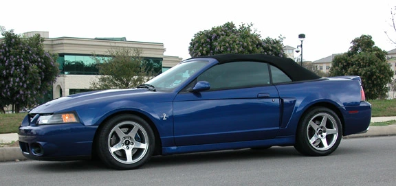

Pics of my GS D3s. 275/40-17 up front and 285/40-17 out back. All on 17x9 stock 03 Cobra rims.
RaceRat said:
wOoT!!! :nice:
Now you need to lower that thing just a tad. :)
Everybody says that. Interestingly enough, a friend just bought an earlier production run DSG 03 Cobra, and it must sit about 1" lower in the rear. :shrug: His springs and my springs are stock. Strange huh?
I need the ground clearance, so it will stay stock height. I just broke 20,000 miles this last weekend (after 7 months of ownership).
-Jason

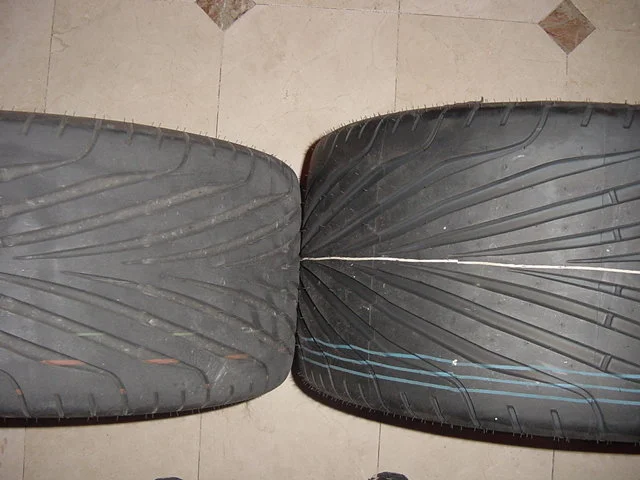

Pic #1 GS-D3 285 (17x9) vs GS-D3 315 (17x10.5)

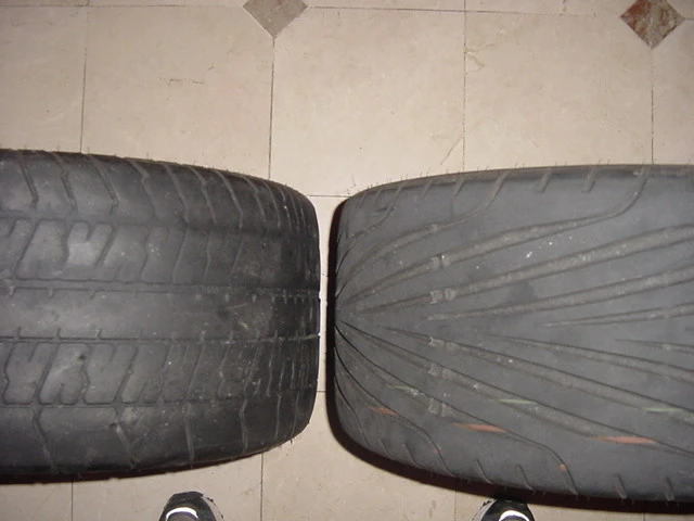

Pic #2 GS-D3 285 (17x9) vs BFG 275 DR (not mounted)
ALso, the 285 on the 17x9 cobra 2003 wheel (not sure if AFS or a stock one one I got) is 53 LBs. And the 315 on 17x10.5 cobra 2003 wheel (AFS) is 58LBs. The 285 is 11" wide and the 315 is 12.5" wide.

Got the pics backwards....PIC623 is the 315 vs 285 both GS-D3s....

Thanks for the comparison pics. I may try the 315s on my 17x10.5 rims next go round. I have 25mm (1") H&R hubcentric integral lug spacers that I can use to get clearance. I may have to look into some thinner spacers though to keep from sticking the wheels too far out.
-Jason
