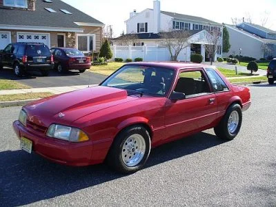

hey names david ive been working on my first car now i just bought an intake n91 cam and eagle 331 forged crank the issue im worrying about is would i have valve problems with trick flow tw heads im thinking about buy forged piston any suggestion and help please thank.
TW heads more than about 10 years old had the valve guide issue, but nowadays TFS is a premium company with very good quality components. That's a good cam, and a great crank. It depends on what you're looking for in pistons. The high end companies that come to mind are CP, and Ross. I've heard good things about Diamond, too. Good luck, and welcome to the boards. Your questions will get more visibility in the 5.0 forums. Please post some pictures.
