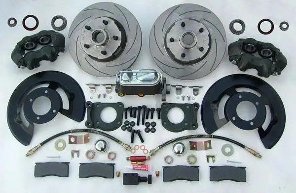

For brakes any easy disc brake kits? Any good 4 wheel disc brake kits?

I have Granada front disc brakes, but there are some other really good ways to go on that. I would advise keeping drums in the rear. Here is a good place for front disc stuff.
Use the OEM style 65-66 front disc kit, it'll cost less than $600 and uses stock 65-66 parts for maintenence. IMHO, rear discs are a waste of money on a street driven car.
