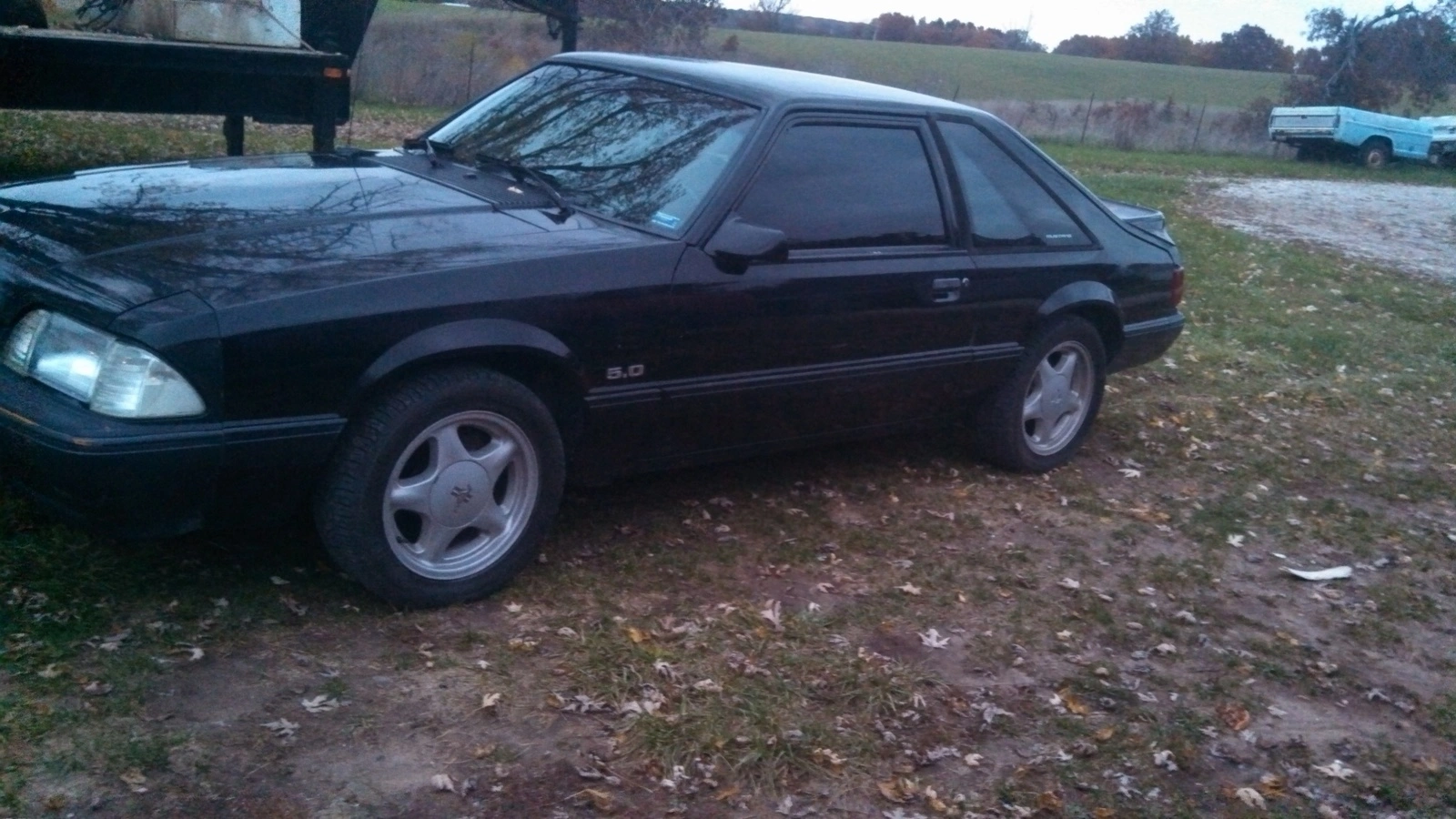

Hey all I'm new here just purchased a 91 fox lx hatch with 5.0 5 SPD. I have quite a few plans for it.. gauges. 5 lug/disc swap and I'm going to repaint it. I also got a trradstone turbo kit(.need to replace turbo) and was wanting some opinions. Should I do a complete overhaul of my 5.0 do aluminum heads, intake and turbo.... or.. I have a 351(not sure w,m,c) and throw it in with some goodies. I want it to haul but want descent street ability. I just wasn't able to find much on 351 here..

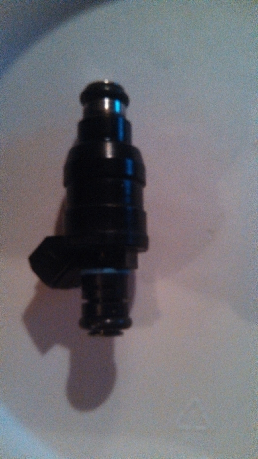

Also have already.. 1.6 roller rockers I * think* 42 lb injectors 3" pro tube Maf. None installed

Do you know what the maf is tuned for? Or is it just the housing and not the element? If the car came w turbo setup I'd guess they'd be 42 lb. I'm not expert though just making an assumption. Also I say stick w 302 tis lighter

302, you don't need to put heads on it with a turbo kit. You will make enough power to split the block if the right turbo is purchased. I plan to boost my stock motor and make 400-450rwhp. Prob try to stay on the lower side to be safe. I bought 60lb injectors just for a little extra. The 42's should be ok though.
