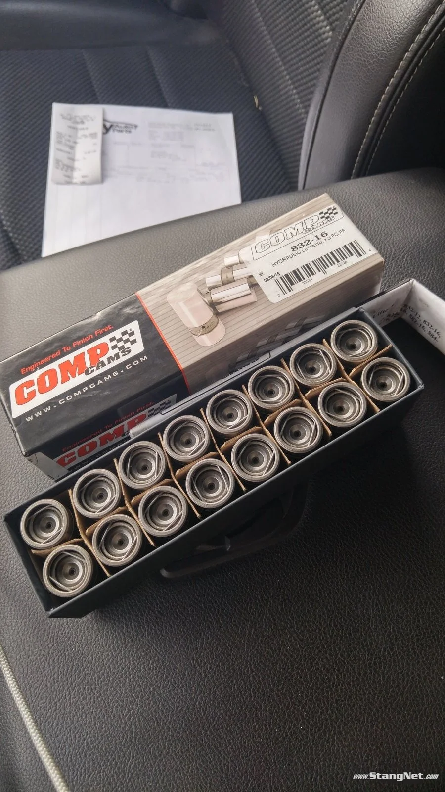

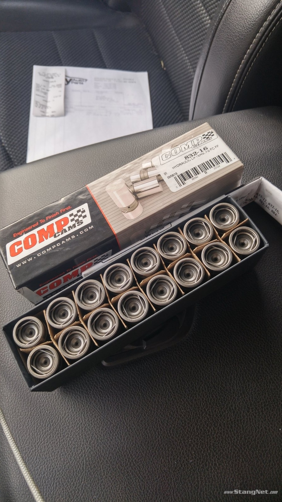

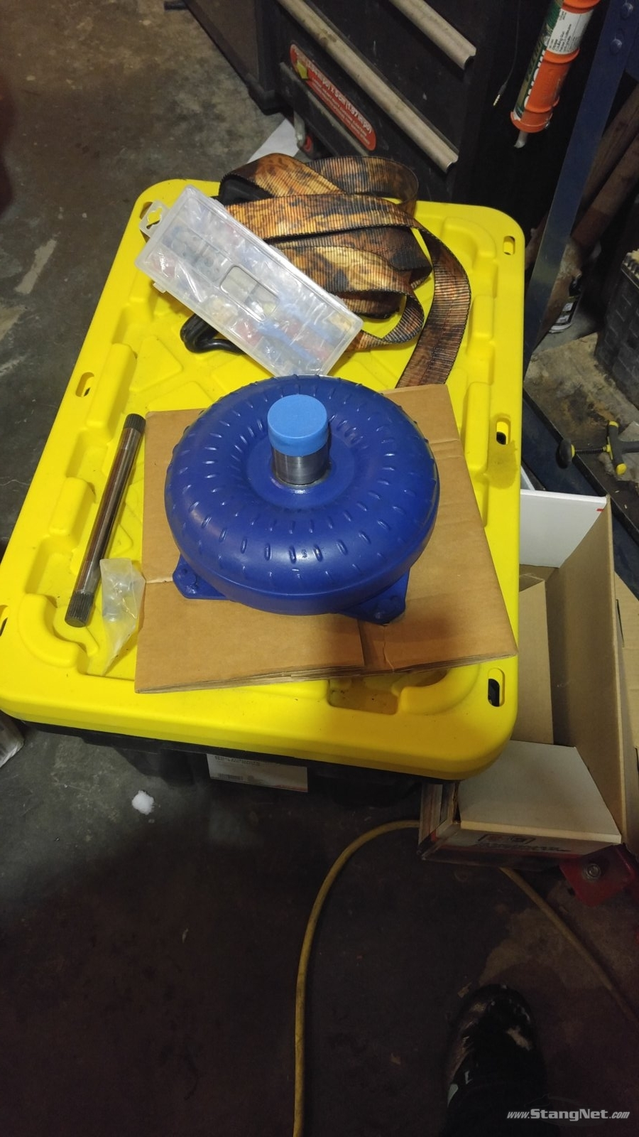

i honestly dont see why 400 at the flywheel isnt obtainable. i watched the video in the link also im not looking for 400 at the wheels till i hit the nos. and it is not going to be a daily driver it will be a weekend car and at the track car. i think i figured out how to get some pics up. let me know if it works.

New parts are always the prettiest thing! Nice!
