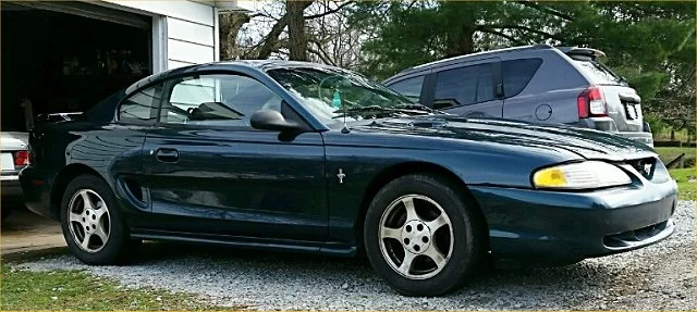

I just bought my first Mustang! Its a 1995 V6/Auto.
Actually runs perfect. CEL is on, but otherwise runs like brand new. Shifts smooth. 142k on the clock.
I seen a OBD2 under the dash on a 95? Actually DOB is 8/94
I don't see that one under the hood where you jump the wries? i was reading that it cannot be a OBD2?
So shuttering in the back....It won't do it all the time. Only owned it for 3 days.
It is experiencing a shuttering type of feeling coming from the back. I check the torque boxes, their good! The bolt holes don't seem to be slotted out if that makes sense.
But sometimes when I am hitting around 30mph, or even under, it will vibrate/shutter in the rear end of the car.
I tried checking the trailing arms, bushings look original, but I used a pry bar, they seem to move slightly, but not very much.
I am lost. If it was the rear end itself inside, wouldn't it make noise or be doing it all the time? I can drive it three times, and nothing. Then sometimes it will do it tow times in a row. NON POSI. I believe.
I am lost!
I did pull the driveshaft. UJoint is older, and moves freely, but doesn't seem bad. I don't know what else to check.
Any advice would be appreciated. I am excited with my first Stang!! But I don't want to keep driving it like this, and I don't wanna start just throwing parts at it. That can get expensive.
