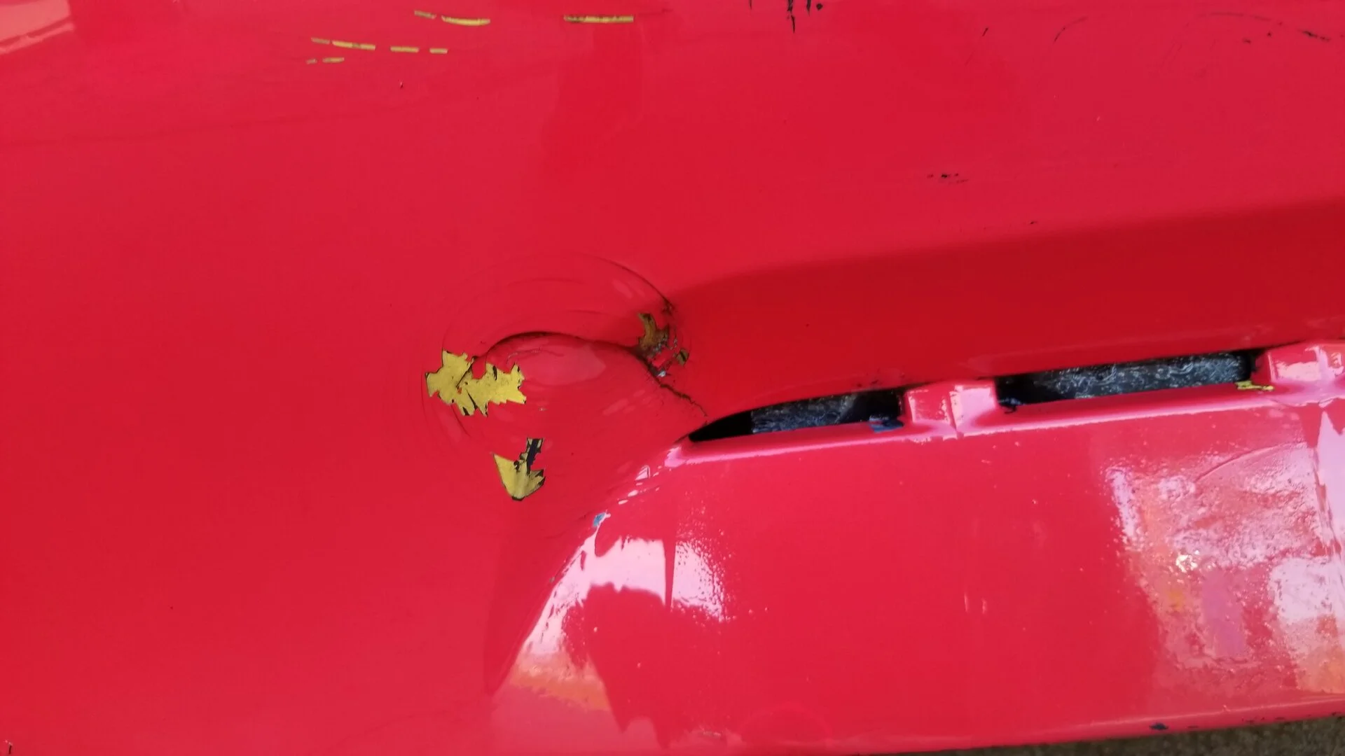

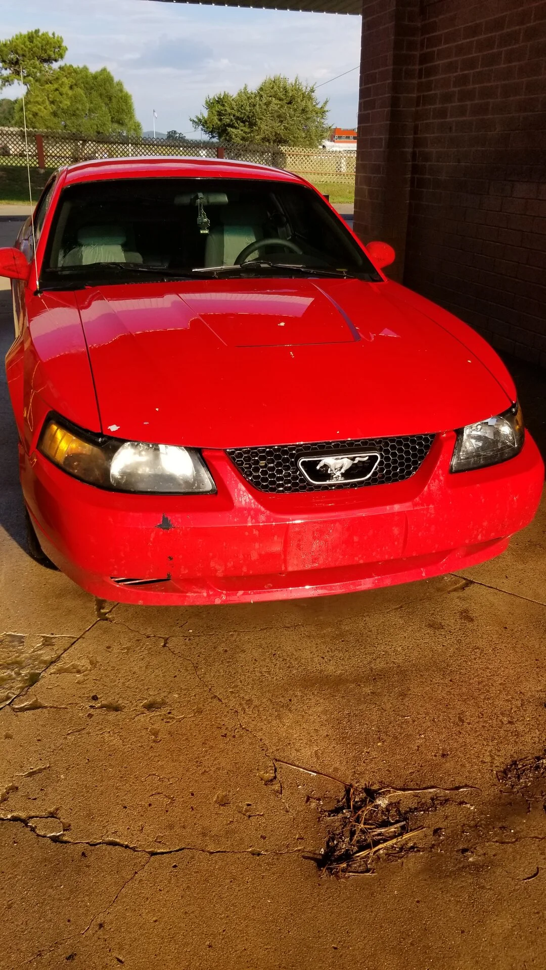

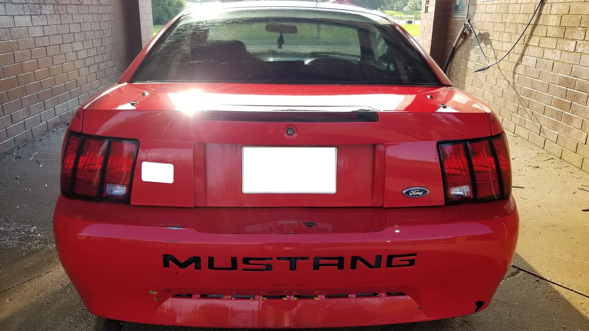

I am not a mechanic by any means but have recently acquired a 2002 Mustang V6 that runs and drives for just $500 but needs a bit of work, mainly cosmetic. I'm slowly learning. I just recently purchased a new cowl grille as this one is busted on both sides. I'm planning on purchasing a spoiler eventually, as well as eventually painting. Any advice on cheap fixes/mods I can do right off? Also, Will I need to install a new rear bumper or can the damage shown below be repaired? I realize it's missing a radiator cover. Thanks in advance!

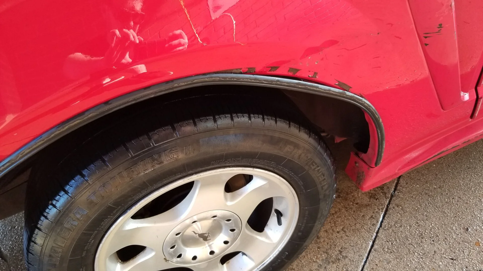

Take that crap off of the wheels wells (it doesn't belong there)
Order some Dr. Color Chip to use while you figure out how to address the bodywork

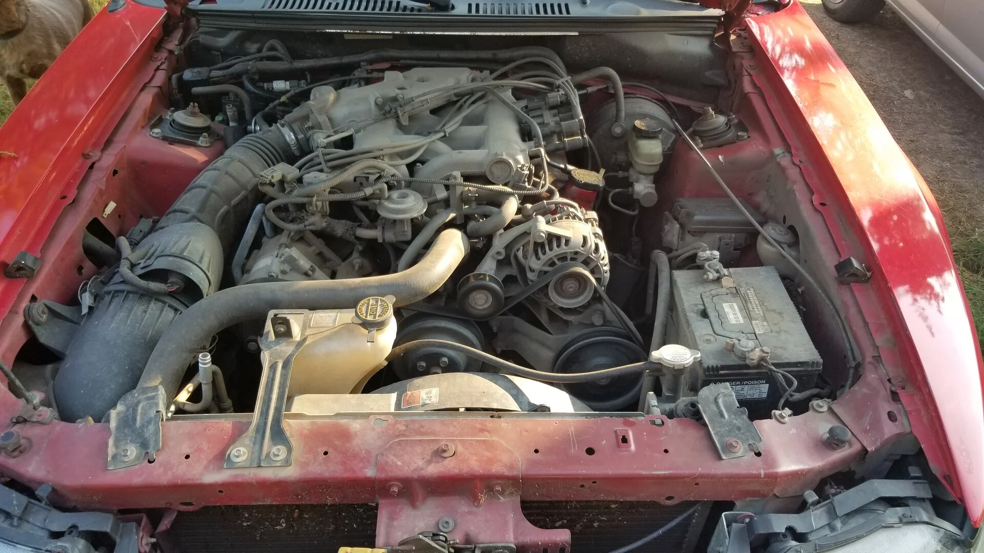

Looking at the engine bay pic, I see the cable ends have been replaced with the clamp on ones. To maintain good connectivity, corrosion must be avoided. I would take them off, clean the posts, the wire ends, and all parts of the clamps. Then spray all the metal parts with battery anti corrosion spray (red stuff). A small can will be enough to keep batteries on multiple cars for years or until you loose the can.
New cables are preferred, but If the other end is good, this will keep the electrons flowing for a long time.
