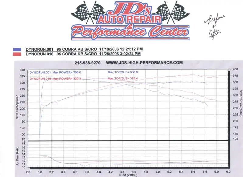

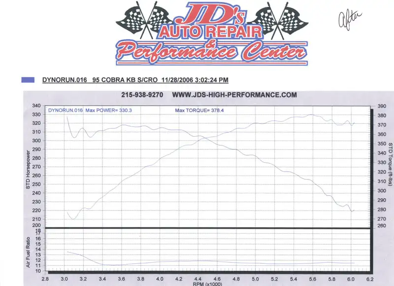

OK i'll try to keep this short as i don't have much time at the moment...
In the late summer my car started pinging (bad) under boost after the car was warm. I took it to my tuner and he pulled timing but it was still pinging. Fuel and heat were not problems. He didn't know what to do so I take it to JD's in PA to have them look at it. They tell me timing is all over the place and think my ECU is bad and i need more fuel. So I get a new ECU, in line fuel pump, and finally find that an accel AFPR will fit with the KB with a little bit of grinding of the side of the s/c inlet. They get everything installed and tuned and take it out and it's pinging! Take it out again and it is fine, take it out again and it is pinging. Come back, take off my msd 6A and it runs fine! the msd was advancing my timing to 20-30 degrees base
So now it is finally running fine with no msd and a new tune. I'm glad i can say she's much smoother and the idle is very good with the new tune so i'm happy about that. Plus higher numbers are always good! Before she made about 325/350 on a 90+ degree day. New numbers are 378.4 torque and 330.3 hp so not bad. This is with a 7 pound pulley that puts out from 6-8 #'s depending on the temp. These new numbers were also with the motor and s/c hot. Timing is base 10 and total 20. a/f is about 11.5 across, the hump at 4.4 on the graph was flattened.
F msd!

i'm sure you are really happy about that. good numbers. you have to love that torque curve!
it must feel like an absolute beast.
but those dynos look weird. the torque and hp curves are supposed to be equal at 5252 rpm.
what's the deal?
what's the deal?
They used different scales for hp & tq
Some day I hope to learn why they do that
what's the deal?
grady is right, different scales. you can see the different starting points on the sides
