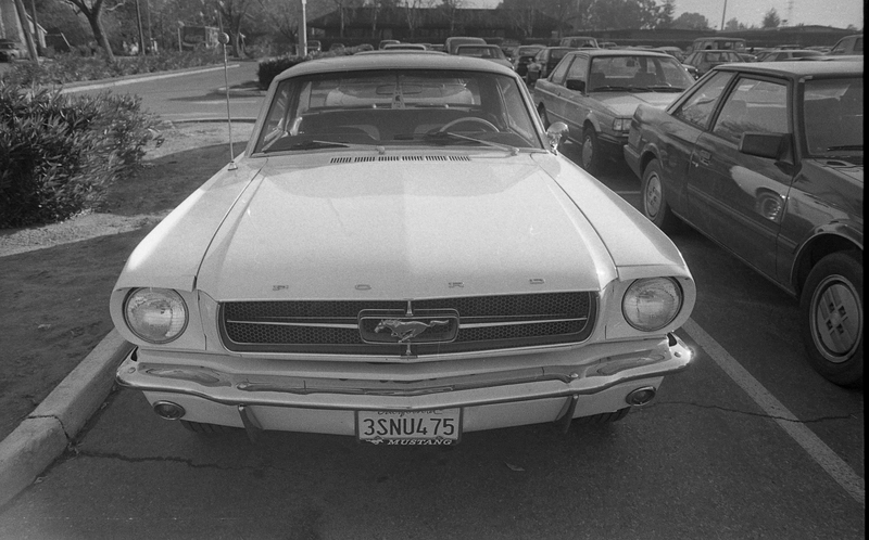

what she used to look like

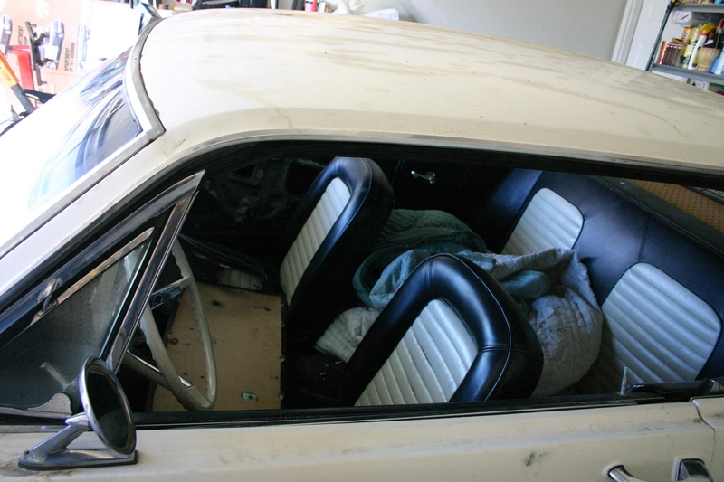

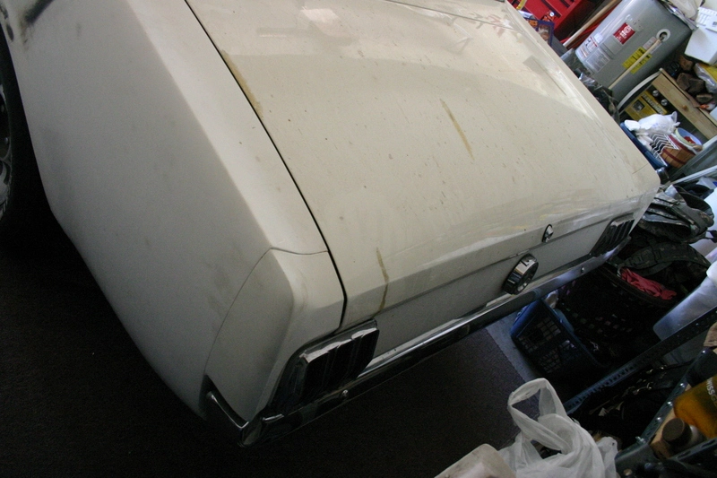

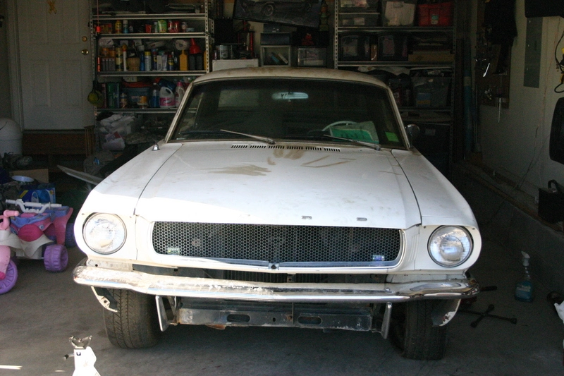

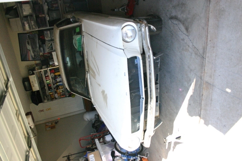

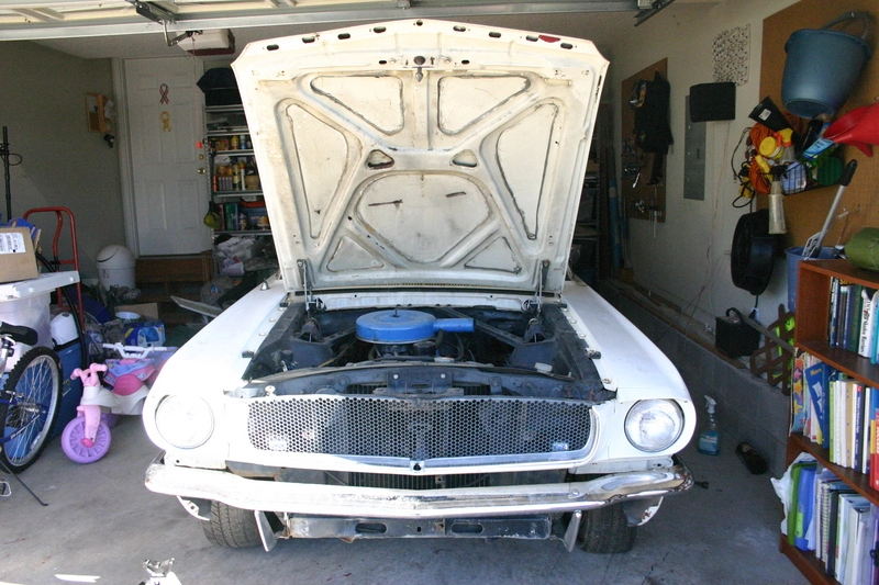

here are some pics.

Even if you go totally "period" you can get 350 hp. In a 302 that would be scary fast. You could also go with a stroker or move up to a 351W. Heck, you could get Ford Racing crate engines up to 347 cid, and dress them out to look like 60's engines.
Just do a lot of reading before you start, and plan ahead. The V8 conversion on a 64-66 does not change the body or the interior, but it changes pretty much everything else. Even the underbody brake line bracket welded to the floor near the axle must be removed and replaced, if you plan dual exhaust.
A lot of people and magazines will try to get you to use all sorts of exotic aftermarket brakes, steering, exhaust, etc., which is fine if your planned use includes such stuff, but a lot of it is just not needed to get great performance out of your car.
