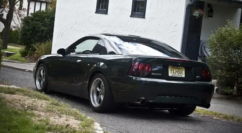

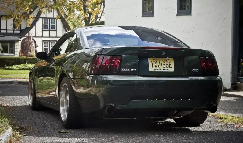

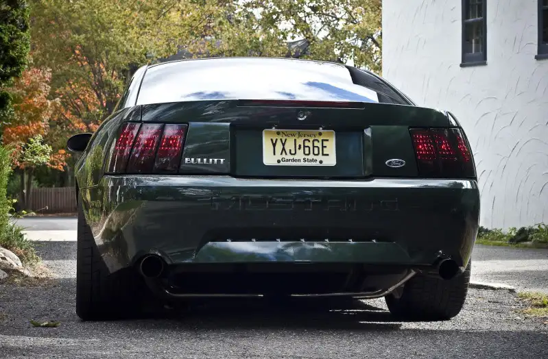

Please excuse the pics, my car is filthy.
