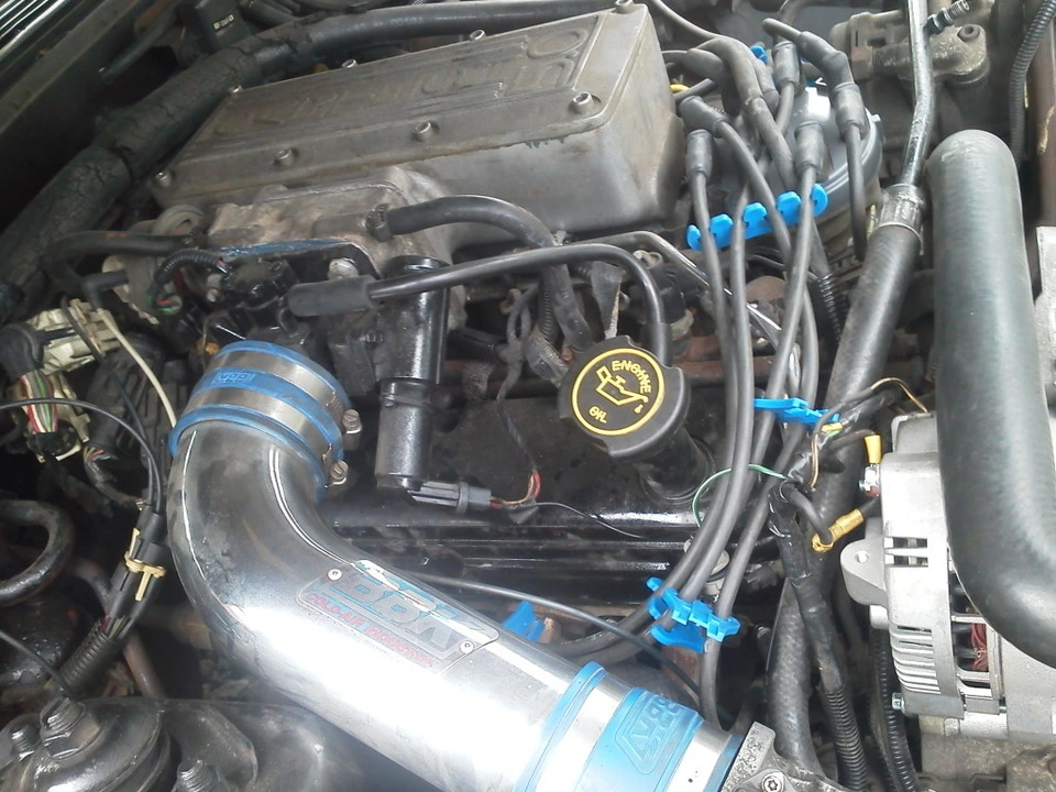

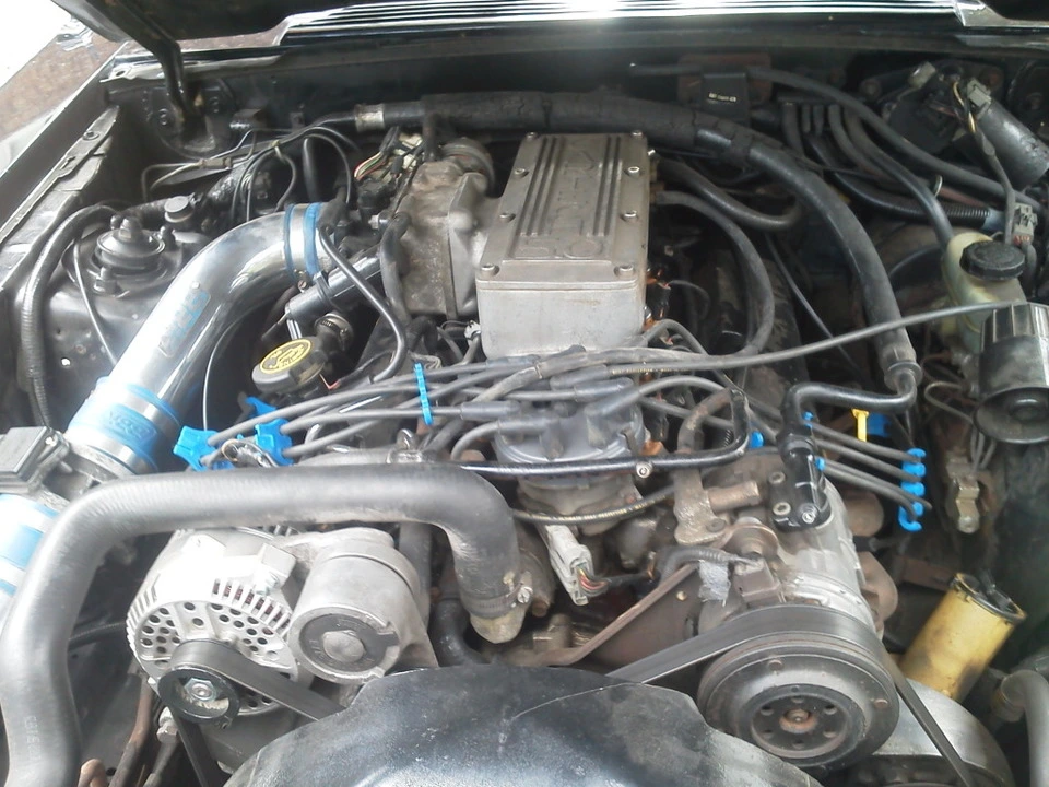

A couple of weeks ago I purchased my 89 lx for $2900 the po didnt know much about it because he only had it for a few weeks before selling. I was wondering if there is any way of knowing what has been done to it? I can see the exhaust is newer, cartech plenum, and the bbk intake in the fender.
How do i tell if it has stock heads and cam?

Fixed the links for you. Don't try uploading them through Stangnet. Just link them directly from the IMG files in your Photobucket account.
Just from the pics, I also see a 3G alternator conversion and possibly an aftermarket shifter assembly. Good start.

If it idles smooth...it's probably a stock cam. lol....otherwise, there's no real way to tell other than pulling the engine down. If the heads are iron, they're probably stock. There's a chance they could have been swapped out to GT40's, which would be identified by a 3 or 4 bar casting on the end of the head...

Get in there with a mirror and a flashlight. You'll see it.

First thing you need to do is fix the hack job wiring on the 3g.
