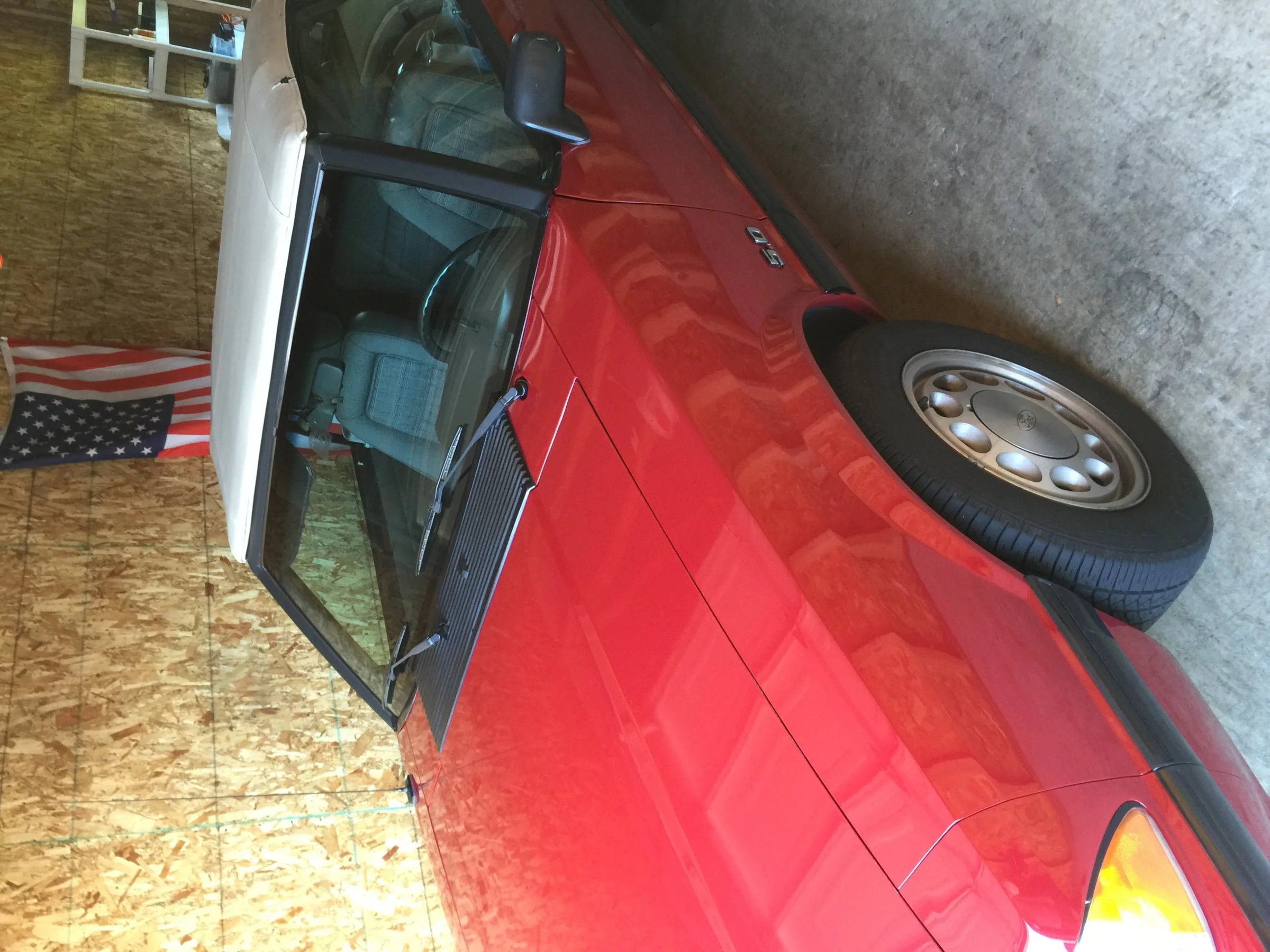

I recently bought a 89 5.0 lx and have never been mechanic savy. Never grew up around cars so I'm in need of a seasoned vet to help walk me through potential upgrades. The 5.0 is completely stock and has no upgrades what so ever. The first thing I'm looking to add is a stronger exhaust to make it sound more aggressive. The issue I'm running into is deciding which way to go and if I need to buy headers and the h pipe along with the exhaust. I have no reason to race the car just wanting a mean sounding stang to cruise around in. It's an automatic convertible and everything still works, even the stock speakers it originally came with. If anyone can please help me out, I'd greatly appreciate it.

Full length subframe connectors are a good start to keep your car from twisting. And if you're looking to make the car faster, cheaply, some 3.73 rear gears. ~$400 for subframes and ~$500 for gears including labor will really change the car.
First of all be prepared to spend $400-$600 plus shipping for mufflers and tailpipes. That price does not include the H pipe.
For a car that is meant to be a street cruiser, stay away from dumps (mufflers with very short or no tailpipes). The exhaust will tend to fill up the cabin in slow or stop and go traffic.
Avoid anything too loud - that includes 2 chamber series 40 Flowmasters. Too loud means that you can't hear the pretty lady sitting next to you whisper sweet things you want to hear. It means you have to turn the volume up on the stereo to the discomfort level to enjoy the music. It also means the car is unpleasant to drive for more that about 30 minutes at a time at highway speeds.
Warning - all chambered mufflers and that includes Flowmasters, tend to drone. About 1700-2200 RPM which is highway cruse speed, the exhaust has an annoying resonance that makes the sound of the exhaust louder at those speeds than at other speeds.
If you are wiling to put up with the drone 3 chamber series 50 Flowmasters are a good choice. Try to stay with 2 1/4 exhaust pipe - it fits better and sounds better - less drone. The result is a smooth powerful exhaust with no raspy sound. It's like a musical instrument that you play as you go through the gears.

Don't bother with headers on a stock motor. Get a good catback system like Flowmaster.dynomax, Borla. or MAC. As mentioned, the first thing to have instaled are Max Motorsports full length subframe connectors. These cars ar unibody and are known to flex and rattle over each bump. That will tie the front and back subrames together. Next, the best performance bang for the buck is a set of Ford Motorsports 3.55 rear end gears. Your car came with either 2.73 or 3.08 gears. By going with the lower( yes they are considered lower even though numerically they are higher) gears, it will increase the acceleration off the line. You can get the complete install kit from Late Model Restoration or American Muscle for around $250 before the Stangnet discount. You will also need to get a different speedometer gear to put in the transmission to compensate for the different rear end gearing. You can get this as wel from those vendors for around $15.
