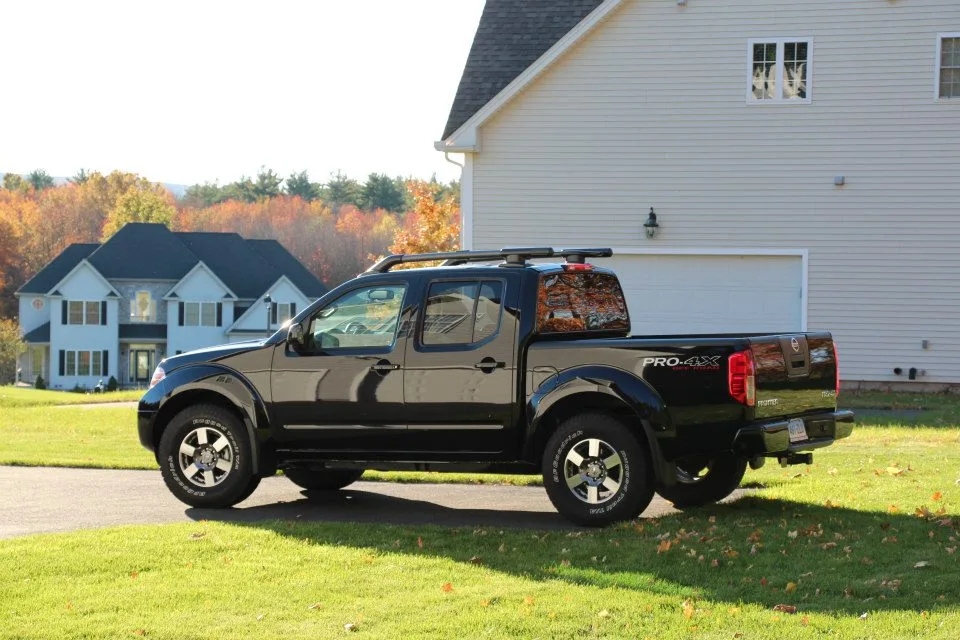

This is what I drive when the weather is bad...
