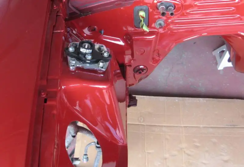

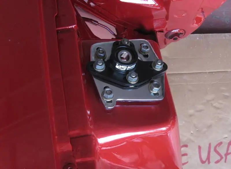

Cleaned up the C/C plates and fit one for now....Cleaned up and the Strut tower and plugged up the STB holes.
Just need to get some chrome bolts for the top of this.

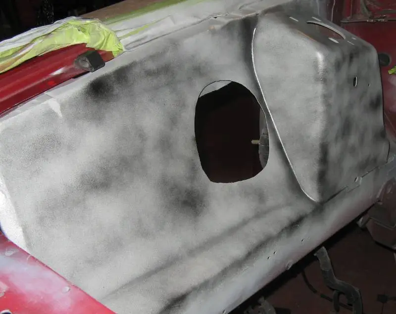

I used Stock exterior E9...it took about 8 oz. The primer was auto primer with hardener additive. The main thing is that the less bondo you can use the better.
1. Make sure bare metal is covered IMMEDIATELY with self-etching primer.
2. Any surface that bondo is going to be applied to needs to be scractech up first for adhesion. DOnt put new bond on old bondo or on primer without rough sanding it first.

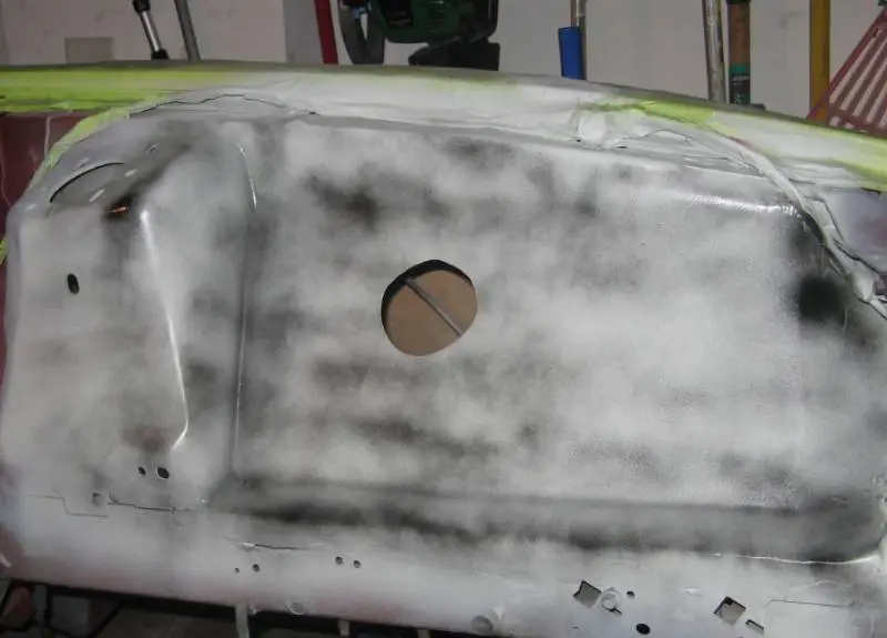

3. sand everything really well. You will need to sand after priming. After your gray primer is on, lightly spray eveything with black spray...as shown in the one photo before paint. What that does is allows you to see where you missed sanding the pimer...You should use a soft 2x3" cardboard folded to about 1/2" thick.. Wrap your sandpaper around that for even sanding. Start with 220 then stop at 320. Use the beige stuff, not the wet/dry black stuff.. If you start to expose metal, cover it with more etching primer. Before paint , the primed surface should fee like glass.
